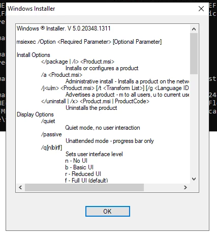

Hi, we are trying to perform a silent install for fme flow 2024.2.3. Because the installer installs on-the-fly some additional software like CLR Types for SQL Server and the Visual Studio Redistibutables, we cannot use our old method of copying a pre-extracted set of cabinet files, as suggested in the installation manual. We have to execute the self-extracting archive and supply the installation properties as a quoted string. We tried a couple ways of coding the properties (single quotes, double quotes, 8-fold quotes) however the script simply seems to install the additional software and then presents in a non-silent mode the fme-flow installer dialog box (see attachment). Anyone have any ideas? Our simple install script is attached to this question too. ​@david_r maybe?

I’ve never had to do this myself, but this whole thing with 8 or 16 quotes isn’t very reassuring… Could you perhaps to try installing Flow and all the compontents into folders without spaces in the names, so that you can remove all the quotes?
Interestingly, the example givben at the bottom of the page looks much simpler since they’re not using this weird quoting technique:
msiexec /i fme-flow.msi /l*v "install.log" /qb /norestart INSTALLDIR="C:\Program Files\FMEFlow\" FMEFLOWUSER=MYCOMPANY\user1 FMEFLOWUSERPASSWORD=password COREHOSTNAME="machine1" ADDLOCAL=FMEEngine FMEFLOWSHAREDDATA="\\machine1\FMEFlowSystemShare\" DATABASETYPE="PostGreSQL" DATABASEHOST="FMEFlowCore" DATABASEPORT="7082" SERVLETPORT="80"
