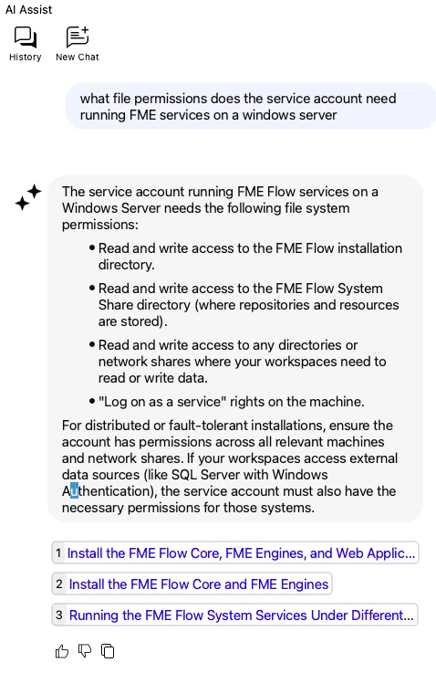

Hmm is the Flow running the services as local, or via a service account https://docs.safe.com/fme/html/FME-Flow/AdminGuide/Running_System_Services_Under_Different_Accounts.htm you need to grant the service account full permissions to the flow share

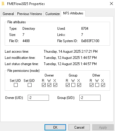

I had tested that login to the windows server via the fmeflow account, and create a file, update the file and delete the file in the FSx shared resource folder successfully. So I beleive I had the full permissions to the flow share.
BTW, could you please guide me to grant privilege on FSx mounted share for the windows account? As I couldn’t see where I could do it in the shared folder’s properites window. Do I need to tick the “W” boxex in Group and Other?

Check that the service account also has the following granted

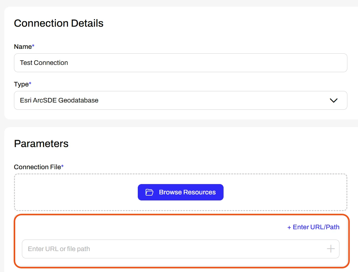

Another thing you could try is adding the SDE connection file using the full file path rather than using the Browse Resources button. This is related to this known issue, however since you already have the file uploaded to the Flow data folder, this may or may not help.

I had tried multiple SDE files and none of them worked in the shared Resources folder. And I also tested to use UNC path directly as you suggested, it’s still no luck, same error messages. But when I copied them to the Windows local drive, like “C:\FME\data\”, then all working fine.
