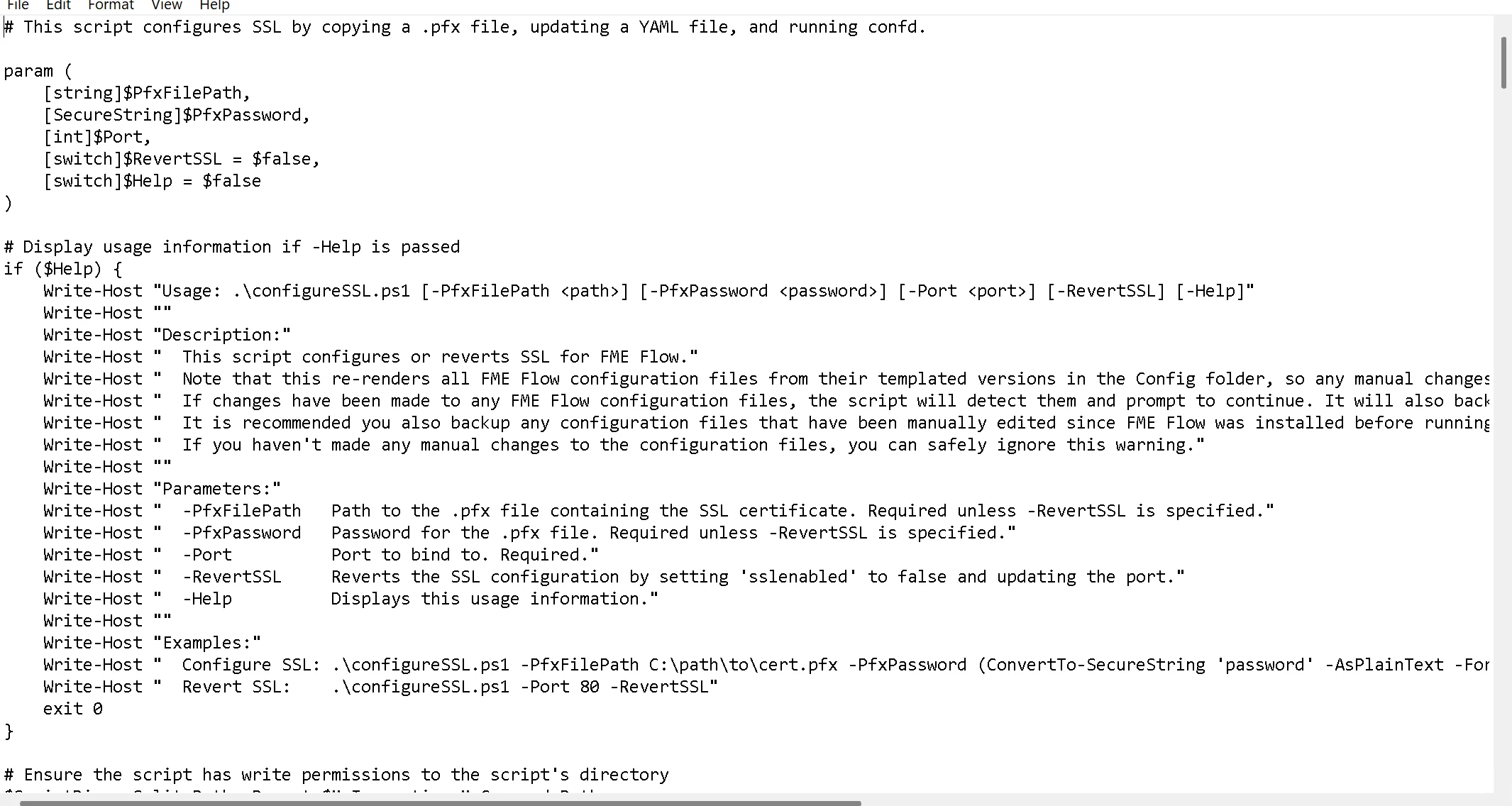

An adjacent script I noticed is configureSSL.ps1 -  "C:\Program Files\FMEFlow\Utilities\configureSSL.ps1
Gives you option to revert the SSL configuration and update the certificate
