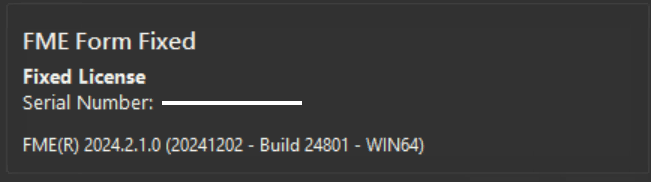

I have the same very persistent error:
Even if I delete the workspace from the server I can’t publish it more than once.
Request to http://fmesrv01/fmeapiv4/repositories/Dashboards/items/upload?overwrite=true returned status code 422.
The workspace is created entirely in this version of FME, so everything is upgraded, including packages.
