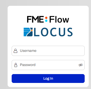

Your mileage may vary, but you can go into the tomcat\webapps\fmeserver folder in your installation directory and amend the underlying html.
For example, in
C:\Program Files\FMEFlow\Utilities\tomcat\webapps\fmeserver\WEB-INF\jsp\login.jsp
You can add elements to the login page. To add the Locus logo I can add a new image below the Flow logo:
<c:if test="${config.titleContent == 'FMESERVER'}">
<script>
document.title = bundle['loginTitle'];
</script>
<img src="${pageContext.request.contextPath}/images/Logo-FME-Flow.svg" alt="Image" height="45px"/>
<img src="https://locusglobal.com/wp-content/uploads/2021/02/logo.png" alt="Image" height="45px"/>
</c:if>
and that will give you:

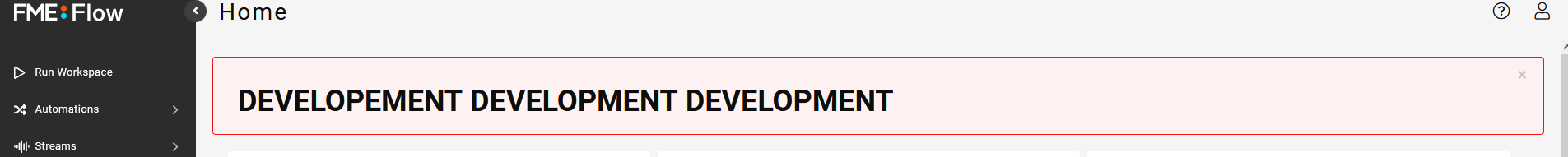

If you don’t want to get into the backend code like ​@hkingsbury and I like to do. You can always create a broadcast message on the home page.
It certainly is not as cool, and won’t show up in server apps, where changes to login and internal logos flows through to everything. But it is certainly quick to implement.
