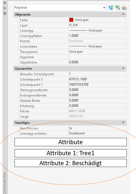

Hello FME community,When creating a DWG file I would like to write some attributes to it. It is important that the written attributes appear in the properties of the object.The following picture shows more precisely what I mean. I want Attribute 1 and Attribute 2 to be appended to the DWG file.Does anyone know how I can attach attributes to the DWG file.Thank you

One way to do this is to use the “Autodesk AutoCAD Map 3D Object Data” writer.

Unfortunately we don't have "Autodesk AutoCAD Map 3D Object Data" as a writer.
The following picture shows this.
Is there probably another way to implement this?
