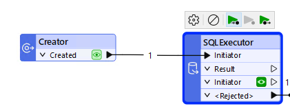

I’d like to use FME to execute some count SQL functions on SQL server (SDE). I’m having trouble with the syntax of the SQL in FME and I’m not receiving any output from the SQL Executor.
SQL I’m running:
SELECT COUNT(*)
from "SDE".SAMPLE;

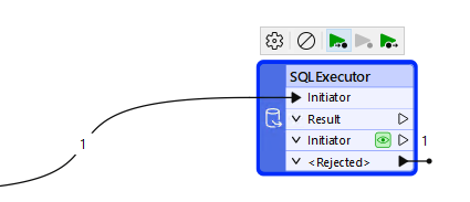

Thanks for your help. I’m still not getting anything outputted via the SQLExecutor Result port.
Here is the log file for the SQL Executor:

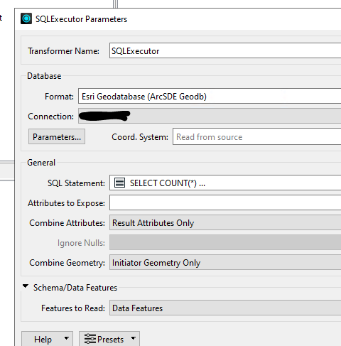

In the SQLExector, open the SQL Editor. (Arrow next to SQL Statement field.) Then in the upper left, click on Database Tables to unfold it. Find your table and double click it to add it to the editor. Just to be sure it written as it should.

Thanks Niels. It turns out that the Database table is correct
I’m able to run a ‘Select * from’ statement successfully, so perhaps something is wrong with how I’m understanding/using the ‘Select count’ function. I may have to reach out to safe support, thanks!
