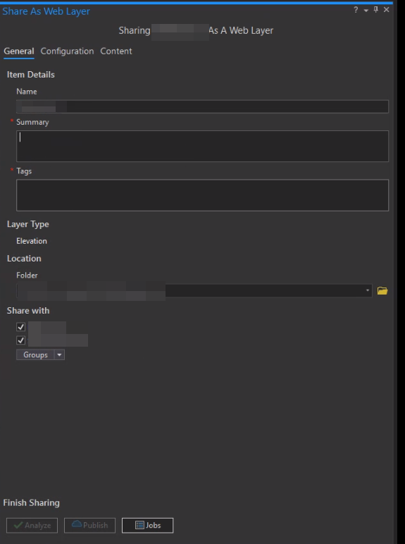

Is it possible to publish an elevation raster as an Elevation layer / Web Layer in FME? Similar to this screen in Arcgis Pro:
  1. By using a regular writer or AGOLConnector?
  2. By pythonscript?
Described here: https://pro.arcgis.com/en/pro-app/help/sharing/overview/web-elevation-layer.htm
