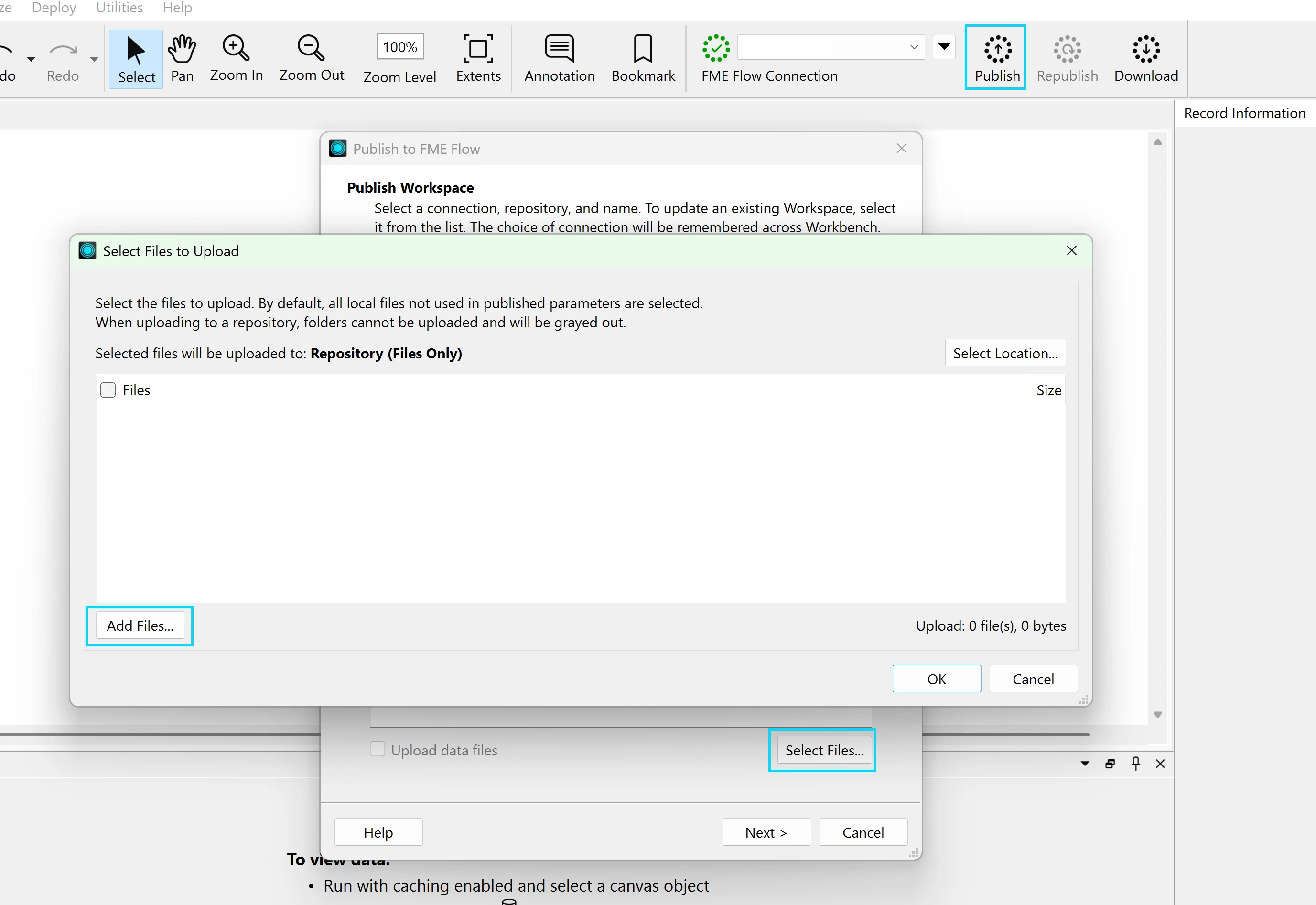

Hi ​@mattwilkie, I can help with your first question. When publishing a workspace, coordinate systems or other resources can be included in the upload:
Coordinate systems can also be uploaded to Resources/Engine/CoordinateSystems, which will make them available to all workspaces on the server. This docs page has more info.
