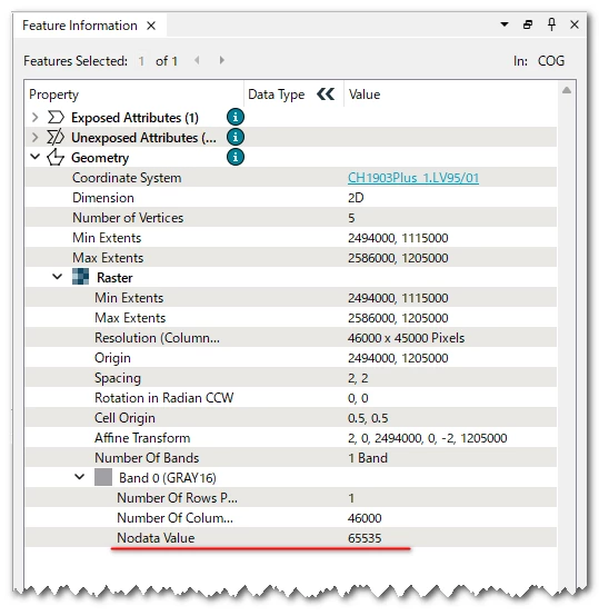

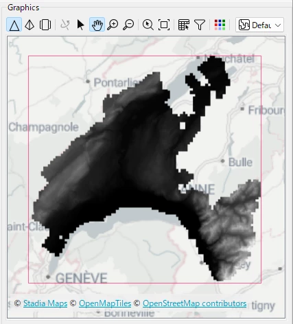

Hi ​@gbcfgeo2025 ,
I checked the GeoTIFF raster you shared with FME, and found that Nodata is defined already, as shown in the screenshot below. Isn't this Nodata definition what you required?
Value of pixels in the transparent part is the Nodata value.

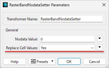

Yes, how can I assign a value of 0 or, for example, -10 to the NoData pixels? Can I set a non-existent (empty) value?
takashi
  • Sep 11, 2025 9:30 AM UTC
You can use RasterBandNodataSetter (Replace Cell Values: Yes) to assign a new Nodata value to the current Nodata pixels. However, the new Nodata value should be 0 or greater, since the band interpretation is GRAY16 (unsigned 16 bit integer). i.e. -10 is not available.
