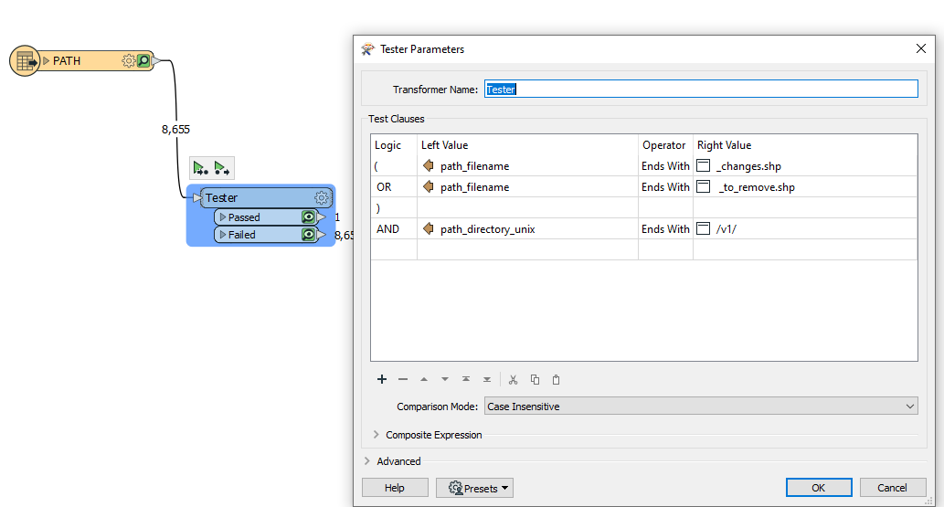

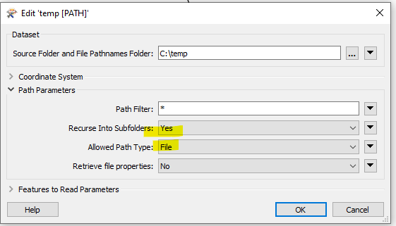

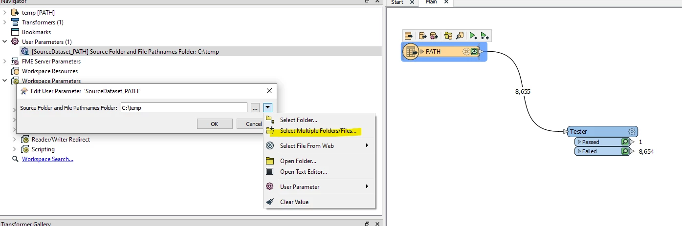

Adding a PATH Reader to the workspace will automatically add a Multiple Folder User Parameter to the workspace as well.
The User then can select Multiple Paths when the workspace is Run
The Writer needs a small tweak, to turn Subfolder Recursion to Yes, and can put in an initial filter at least to only return File Paths rather than Folder Paths.  The Path Filter could optionally also be set to *.shp but going to do that in the next Tester step anyway.
So then can flow all these File Paths into a Tester to find which meet the file filtering rules

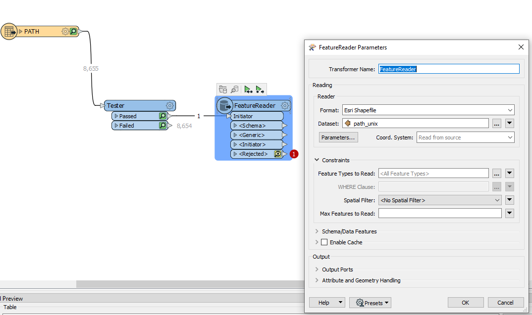

and can then send these filtered file paths to a SHP FeatureReader
bwn
