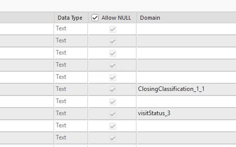

Actually, i am reading feature class from database using the ArcSDE reader, and this feature class has multiple fields which has domain. Now i want to write this to a new feature class, but when i do this and check fields in data design in the “Domain” is empty. I hope you understood what i meant. The below picture shows the field data design of input feature class.
from the article, what is understood is (sorry, correct me if i am wrong) one method is resolving, which is creating new fields, that is not what i want. Then the next method is writing coded domain one by one. which is not possible. Moreover of i have to schedule this workspace, so if any new field with domain comes, it should also be copied.

Again, this is not something I do on a daily basis, but I believe creating a new featureclass where domains are assigned to fields is not possible, out of the box. I think you’ll need Python to do so. Probably something like:
  • PythonCaller to get list of domains assigned to fields in original featureclass(es).
  • SchemaScanner to generate schema feature.
  • Sampler to sample 1 feature.
  • FeatureWriter to create the featureclass using one feature. If this needs to be dynamic, you also want a schema feature from the SchemaScanner.
  • PythonCaller to assign the domain(s) to the field(s) and remove the first feature.
  • FeatureWriter to insert all features.
I have not tried this before, would assume it is doable, but it is not easy.
