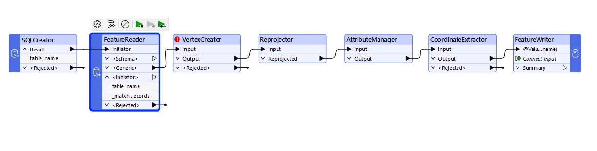

I would like to know how to pass a dynamic variable to the FeatureWriter that is generated in the SQLCreator at the start of the process.
If I explicitly write the name of the feature class name it works, if I try a pass the table name identified in the SQLCreator it fails, it looks like it is passing an empty string as the name

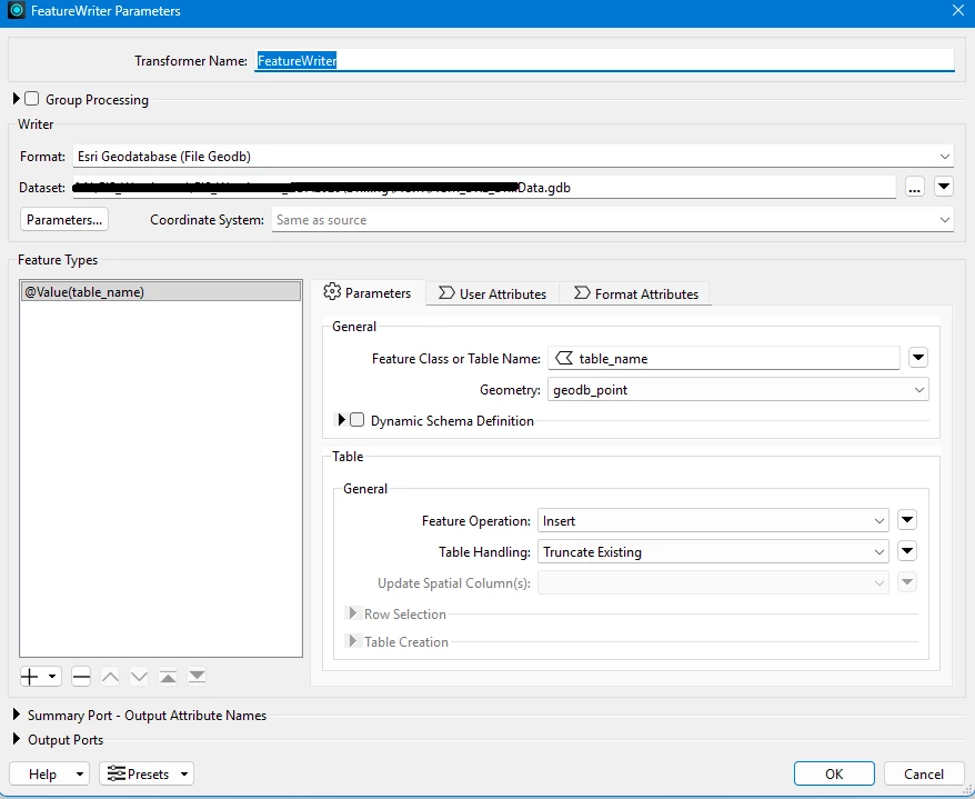

Below is a screen shot of the table_name variable being used.

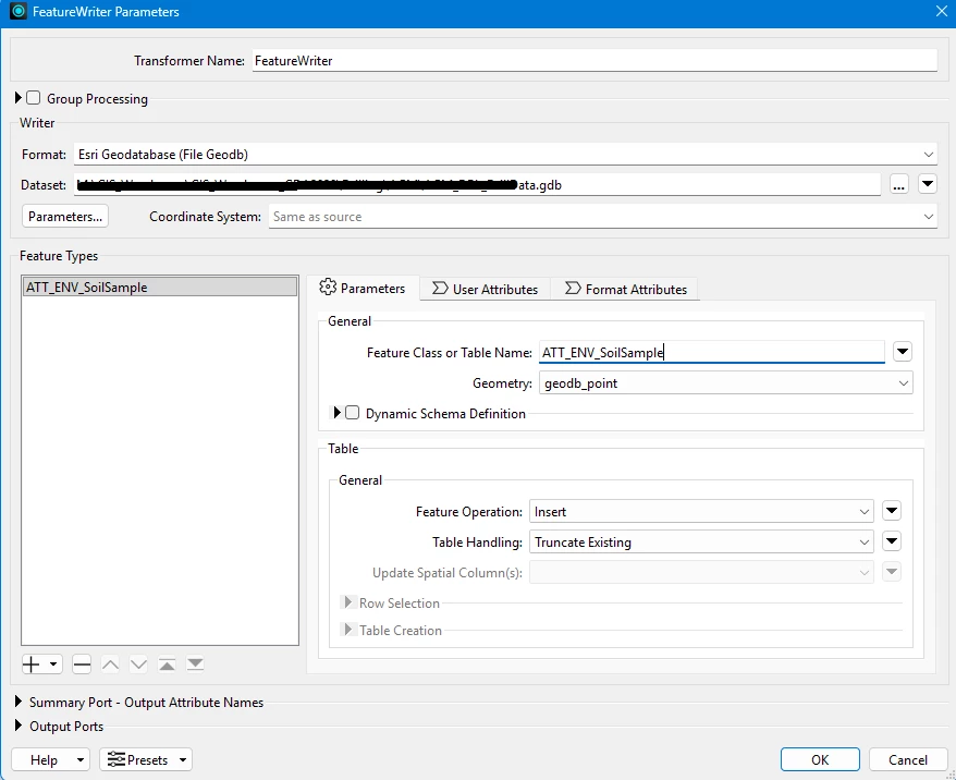

Below is a screen shot of the name being written, this works.

On the feature reader do you have Accumulation mode set to merge initiator and result?
If you haven’t got this set, the table_name attribute won’t be populated on the data coming out the generic port

I did add the File GDB as a connection that allowed me to use it as a schema source in the Dynamic Schema Definition and made sure to check dynamic in User Attributes.
This works for the use of Truncating Existing, but not for Create If Needed table handling.
