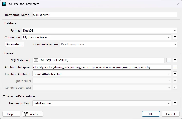

What I have done is create a DuckDB database connection to a .duckdb that contains a view definition of your S3 files, using a glob path for the files you want.
Then in a workspace use a SQLExecutor to read the data:
FME_SQL_DELIMITER ;
install spatial;
load spatial;
select * from "MyDivisionView";
Loading the spatial extension may not be required for your data.
