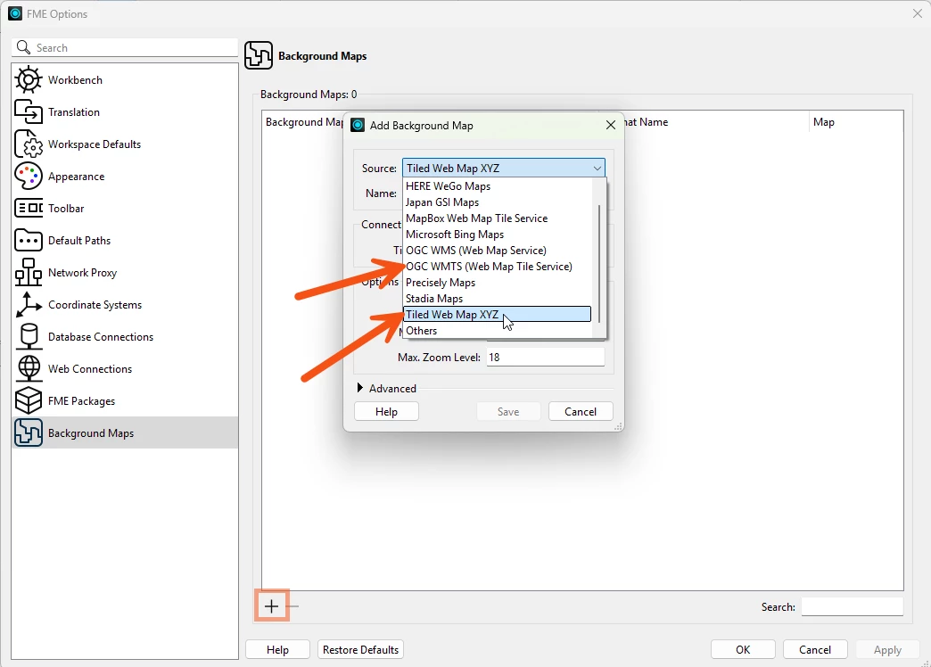

Hi ​@ingalla! Did you happen to run into any particular issues trying to use the basemap?
I haven't tested this myself but looking into their OS Maps API documentation, you should be able to use this service.
Looks like OS has OGS WMTS and ZXY versions available, which in FME, may fall under OGC WMS (Web Tile Service) and Tiled Web Map XYZ.
FME Options>Background maps> “+”
Depending on the API version, the configuration may be a little different.
Let me know how it goes though! Happy to figure this out with you and the community

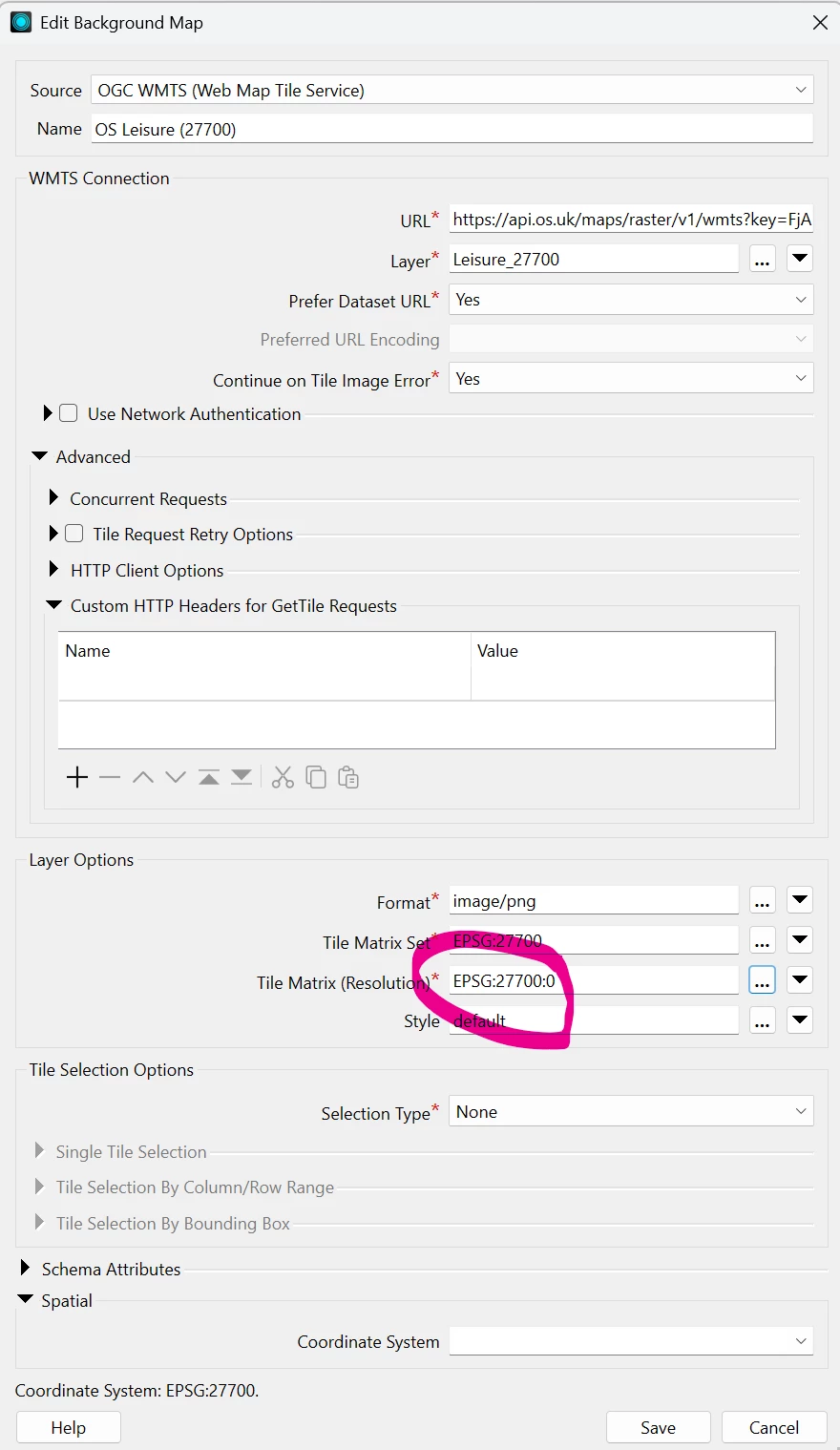

mapmonkeythe2nd
Forum|alt.badge.img+3
I have also had problems adding the OS Maps Web Service as a background. No problems testing the API with QGIS, ArcGIS or AGOL using the below parameters.
Error is
FME Objects Worker [27672] > Failed to read features from dataset 'https://api.os.uk/maps/raster/v1/wmts?key=xxxxxxxxxxxxxxxxxxxxxxxxxx' using the 'WMTS' reader

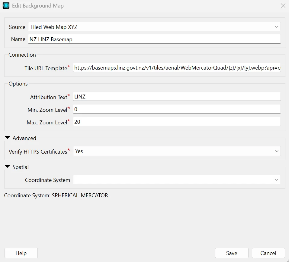

Also tried the XYZ and got similar message
FME Objects Worker [37664] > Failed to read features using the 'TWM_XYZ' reader
I have a similar issue with the LINZ NZ Basemaps service and get the same error (URL works with QGIS, ArcGIS or AGOL)

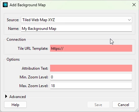

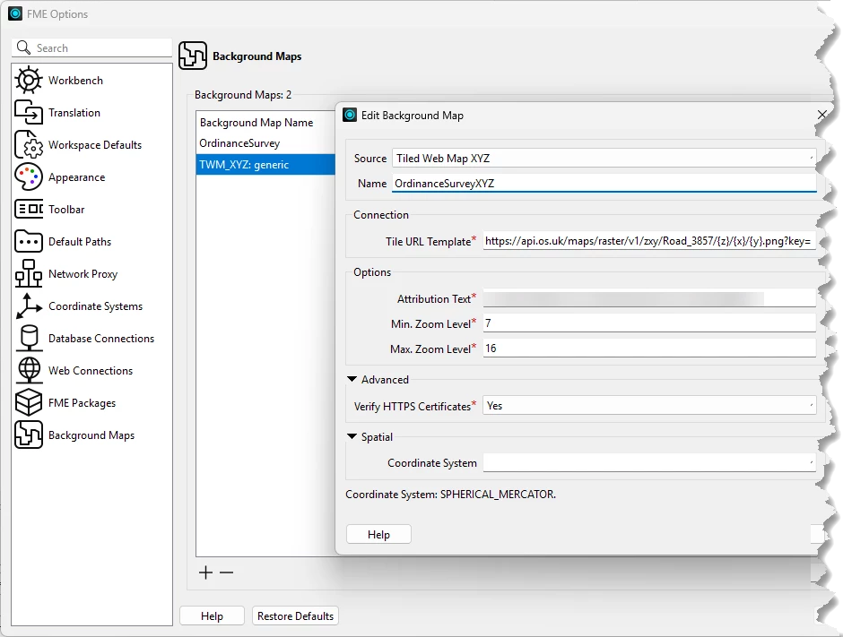

I managed to get this working! Here's what I found helped with the Tiled Web Map XYZ setup:
Getting the right settings from OS Maps API:
Cross-reference the OS Maps API doc Layers and Styles to confirm these details match what you need.
Configuring the Base Map in FME Options:
  • Tile URL Template: The URL from above
  • Min Zoom Level: 7
  • Max Zoom Level: 16

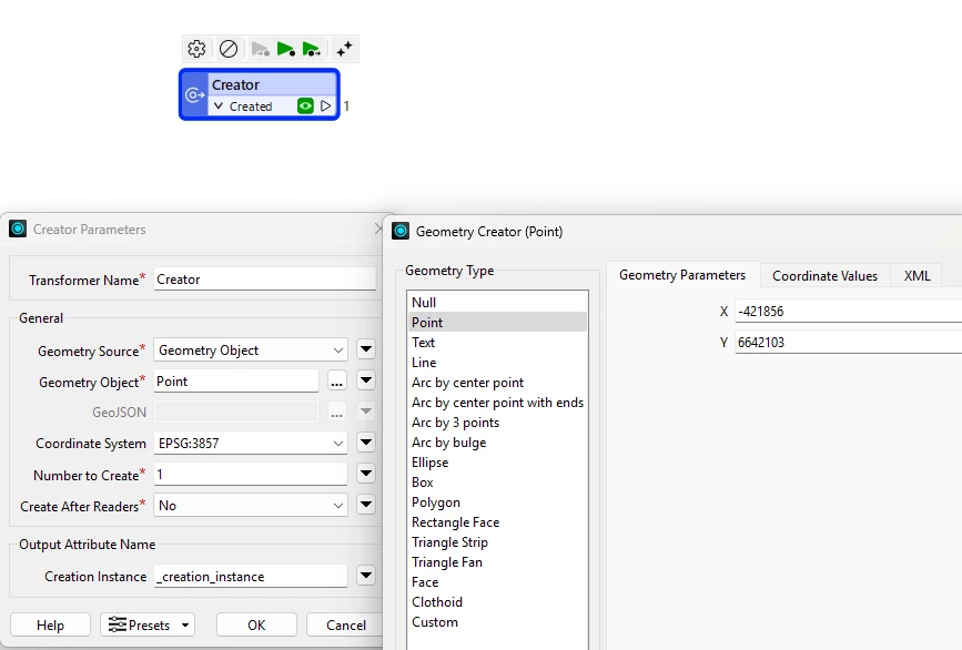

Testing: I tested with a point at coordinates (-421856, 6642103) in EPSG:3857, and it displayed correctly once everything was configured.
One gotcha I ran into: Initially I was testing with a point outside of Great Britain, which just showed an empty map. Is that what you folks were seeing, or is something else going on? Happy to help troubleshoot further if you're still stuck!

Great that works - it seems that you do need to have the correct zoom parameters for the XYZ service.
I am still strugling with the WMTS service - I am not sure of the Tile Matrix Resolution values?

​@mapmonkeythe2nd As for the Tile Matrix Resolution value, it's being removed for background maps in newer builds. As I understand it, this parameter helped FME calculate zoom (resolution), but FME will handle this automatically going forward. In the meantime, you can safely set this to any value, if it appears. Hope this helps! 🙂
