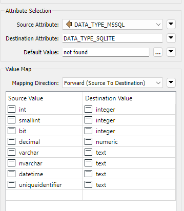

Currently, I’m reading the schema from MSSQL and manually mapping each attributes data type from the MSSQL definition to SQLite using an AttributeValueMapper.
Now it wouldn’t take too much effort to make this list exhaustive, but there is surely a better way.
