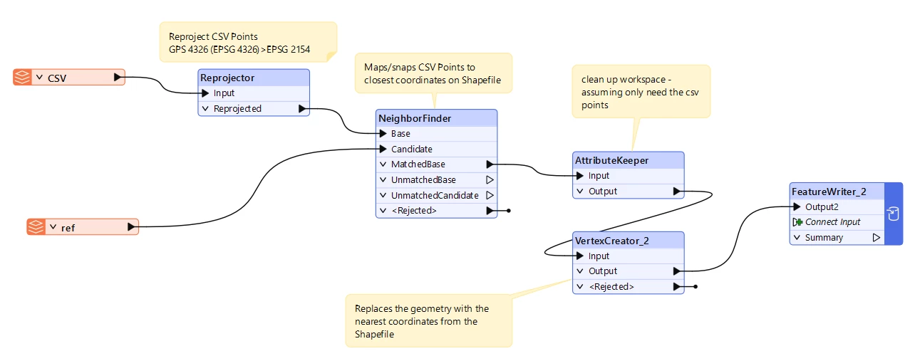

Hi ​@marionmahot! If I understand your case correctly, you should be able to do primarily using a Reprojector and NeighborFinder. I’ve shared a workspace of what I tried, hopefully it will help or at least steer you in the right directionΒ πŸ™‚
I think you may also be able to do this using the Snapper, but I didn’t really explore that transformer
Here’s what my workspace does:
  • Your GPS points (from CSV, in EPSG:4326) are first reprojected to match the road reference’s coordinate system (EPSG:2154) using the Reprojector.
  • The NeighborFinder transformer then finds the closest road segment (from the shapefile) for each GPS point, effectively β€œsnapping” each image location to the road reference.
  • The AttributeKeeper keeps only the relevant attributes, including the coordinates of the closest road point.
  • The VertexCreator replaces the GPS point geometry with the snapped (matched) road coordinates, ensuring your output is spatially aligned with the road.
  • Finally, the FeatureWriter outputs the results to a CSV, so each image is matched to the nearest road location.
(created using FME 2025.1.1 but the principle should be more or less the same for other versions)
