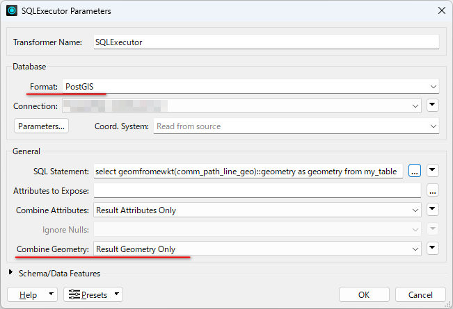

Hi ​@fpakzat ,
I think this query would work with SQLExecutor.
select geomfromewkt(comm_path_line_geo)::geometry as geometry from my_table
Make sure that these parameters setting in the transformer.
  • Format: PostGIS
  • Combine Geometry: Result Geometry Only

Hi ​@fpakzat ,
  • Format: PostGIS

Hi ​@takashi ,
The solution worked fine this time especially the “Result Geometry Only” option.  Thanks a lot.
