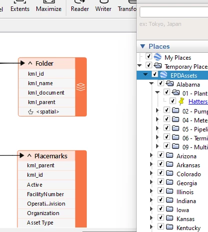

I’ve seen both examples of creating KML:
https://support.safe.com/hc/en-us/articles/25407754952717-Creating-KML-Folders-Through-KML-IDs
https://support.safe.com/hc/en-us/articles/25407609389453-Creating-KML-Folders-By-Feature-Type-Fanout
I’m able to create folder structure:
When I tried to add placemarks under subfolder, my folder structure gets overwritten.   Subfolder has ID in the form of State and AssetType (minus spaces and special characters, you can see the ID below in folder name).
Example, Alabama’s only plant asset has parent ID Alabama01Plant.
What am I missing?  Have latest FME 2025.1 Form.

Which of the two methods you mentioned are you using? If you are using the kml attribute method I am assuming your folder levels are something like this?
Level 1:
kml_id= value(State)
kml_parent= doc
Level 2:
kml_id= value(State)value(AssetType)
kml_name= value(AssetType)
kml_parent=value(State)
Features for both of these levels are created and sent to the kml writer as a folder.
Placemarks:
kml_id= value(example)
kml_parent= value(State)value(AssetType)
Level 1:
kml_parent= doc
Level 2:
Placemarks:
I used KML ID method, already had everything configured the way you suggested.  For some odd reason, it worked today.  See screenshot.  I’m not sure what I did last week prior to leaving, but it’s perfect now.  Now I’m curious as to why it worked.  Tried it a few more time, KML is exactly as intended.
