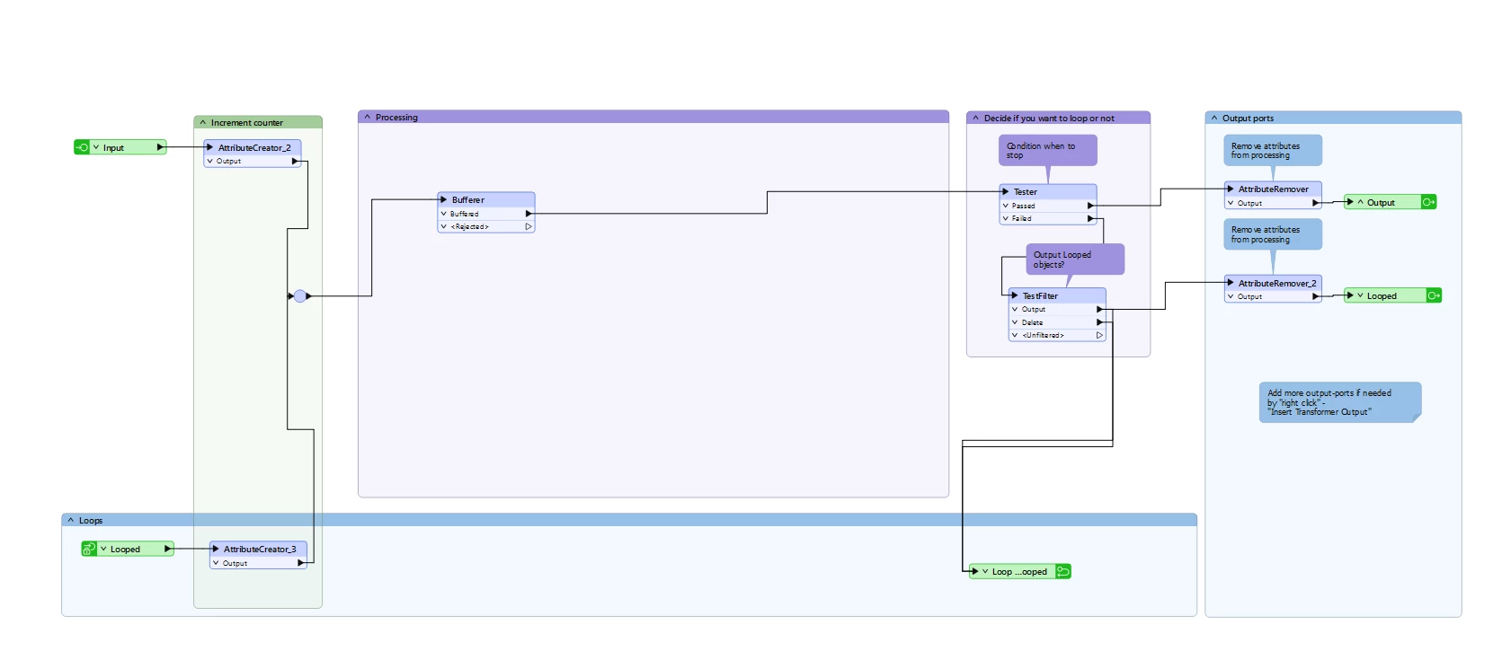

Check out the “Looper” found via custom transformers.
You can edit it as it is a template:
Add your bufferer and neighbourfinder in processing and adjust the testers/attribute creators to stop once no neighbor is found.

​@max_h  when I use the neighbor finder in the looper i get an error. Any idea?
Loop to Looping_Looped1765832145 Input Splitter (BranchingFactory): Transformer/Factory Looping_NeighborFinder is blocking and cannot be used in a loop, but was found between 'Loop to Looping_Looped1765832145 Input Splitter' and 'Looping_Looped1765832145 Input Splitter'
max_h
Forum|alt.badge.img+39
  • Dec 16, 2025 7:15 AM UTC
My bad, didnt know neighbourfinder is blocked in a loop.
