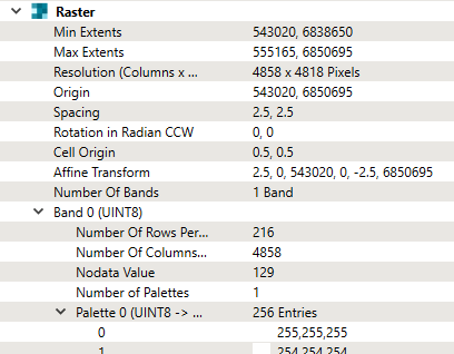

For reasons that I don’t yet understand, not only is my data ouput uint8 instead of int8, but, my output file also has a pallete which I know shouldn’t be there - and I know that palletes can’t work with int8.  I have attached my current workspace and could provide some cut down input raster files if necessary.
For my workspace, this is what FME is telling me when I read the generated tiff file (note uint8 and pallete):

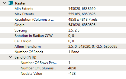

This is the raster attributes immediately before the GEOTIFF writer (note int8 and no Pallete):
