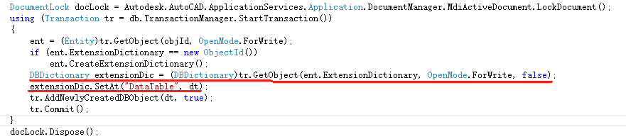

How to use FME to read the Extension Dictionary of DWG data objects, that is, the associated information of the objects?

The Extension Dictionary information is written using C#, as shown in the picture below:
Best answer by hkingsbury
Is this coming from a dll?
You can use python to read the contents of them and invoke the functions within - https://stackoverflow.com/questions/252417/how-can-i-use-a-dll-file-from-python
