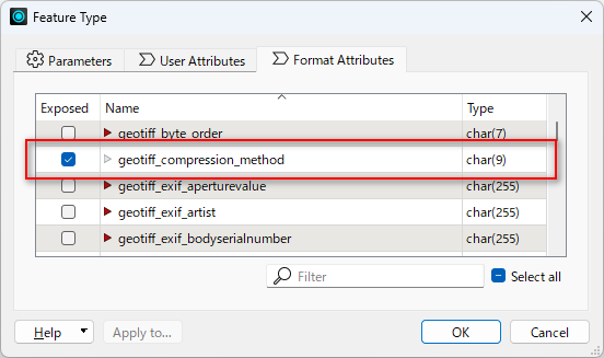

I am building a workbench that has a GeoTiff Reader, and uses the RasterPropertyExtractor and CoordinateSystemExtractor transformers to report on various qualities of the input image. The bounds, the cell sizes, etc.
I am hoping for a transformer that reports on the compression method of the input image. LZW or JPEG or something else?
Something similar to CoordinateSystemExtractor but instead a CompressionExtractor
Best answer by takashi
Hi ​@nicholas ,
GeoTIFF reader reads the compression method as a format attribute called “geotiff_compression_method”, if the source GeoTIFF file was compressed.
takashi
  • May 29, 2025 1:36 AM UTC
Hi ​@nicholas ,
nicholas
Forum|alt.badge.img+14
  • Jun 3, 2025 3:56 AM UTC
Thankyou ​@takashi
I took your advice.
I also added a NulAttributeMapper for those cases when the image is not compressed.
