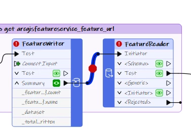

You are absolutely correct when it comes to the creation of the feature service first before reading the feature url and then using that feature url to use the Add Attachments action item of the transformer.
There is an enhancement/Idea request to expose the feature service feature url as an output attribute of the feature writer so that we can make this a single workspace workflow.  IDEA-2341: Esri ArcGIS Feature Service – Expose Feature Service Web Service URL as an Output Attribute in the ArcGIS Feature Service Writer
You can’t avoid hardcoding the output feature service in the feature reader to make it look seamless.
In one of my demo for this workflow I added a breakpoint to highlight this gap.
One option that you can try is to use the List action item to show all the services and then find a way to retrieve that newly created feature service to pass downstream to your add attachment transformer. If you need assistance with the workaround, please DM me.

Hi ​@mgg_beca apologies for the delayed response, sounds like this is a good use case for the FeatureReader & FeatureWriter!
These transformers act as regular readers and writers with the added benefit of placing them in the middle of your workspace. A FeatureWriter can initiate a FeatureReader or other transformers in your workflow. If you are able to pull the URL from the FeatureWriter after writing to AGOL you can perform the attachment upload after like you planned without hardcoding the values.
Hopefully this helps or gives you some ideas!
