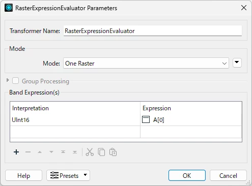

The interpretation of the source PNG raster is RGBA32 and it only has 2 values - opaque black (0,0,0,255) and opeque white (255,255,255,255). You can use RasterExpressionEvaluator easely convert it to Uint16 single-band binary raster whose cell values are 0 or 255 for example. The setting example is shown below.
RasterExpressionEvaluator Setting Example
Uint16 single-band raster itself cannot represent colors, but you can set this palette to the raster with RasterPaletteAdder in order to assign color (R,G, B) for each cell value.
