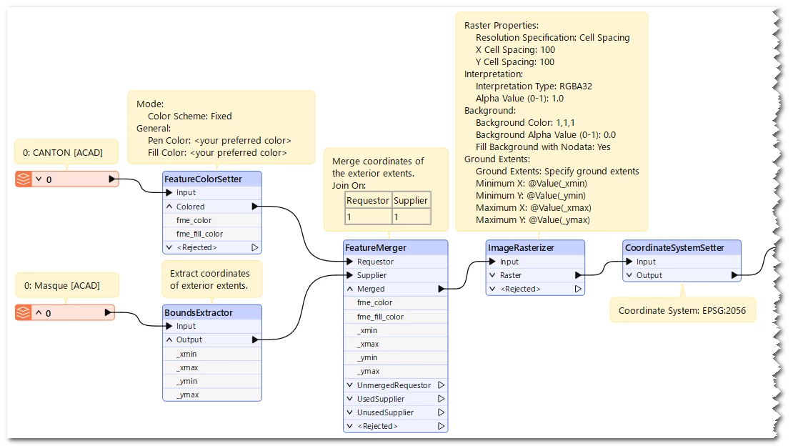

I suppose that you are attempting to create a raster which draws a polygon read from CANTON onto a transparent rectangle read from Masque.
If I understand your requirement correctly, FeatureColorSetter and ImageRasterizer might help you.
The screenshot below illustrates a workflow example. X/Y Cell Spacing (100) and Background Color (1,1,1) are just examples, modify them preferably.

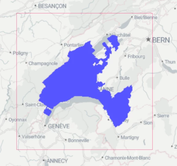

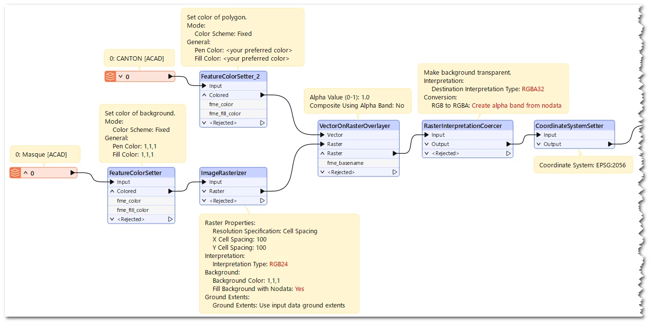

Alternatively, VectorOnRasterOverlayer coud also be helpful, as in:
Result : The red rectangle represents the extents of the resulting raster, originated from Masque.

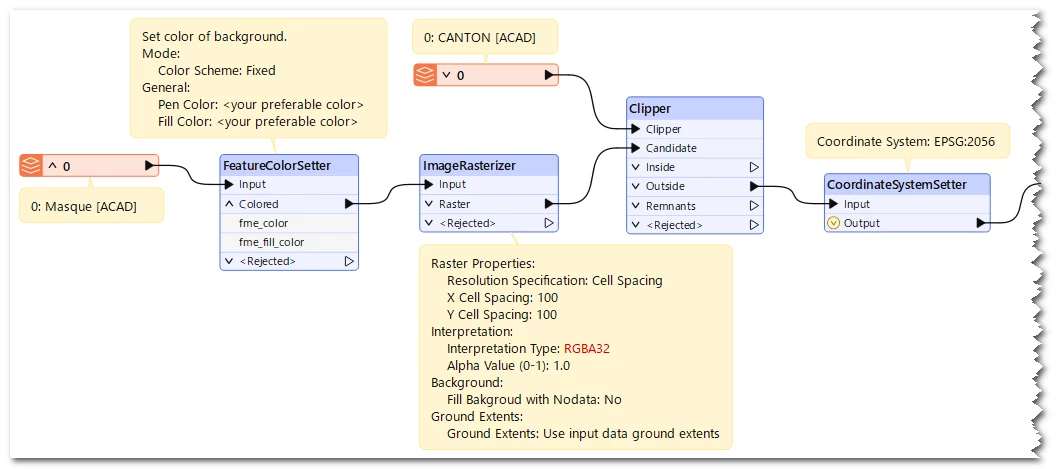

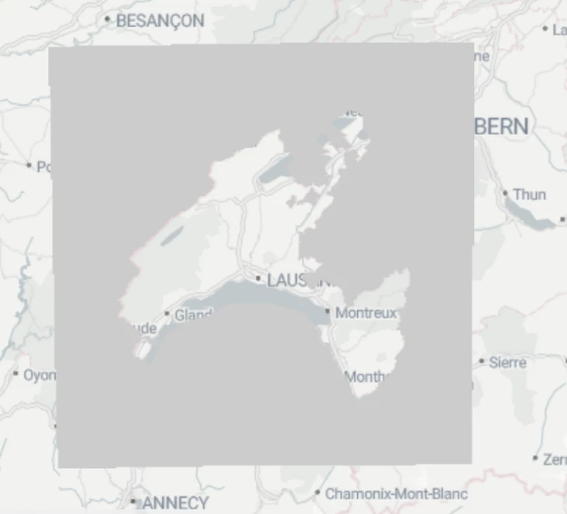

takashi
  • Sep 10, 2025 12:31 AM UTC
Oh, I misunderstood your requirement, interior of polygon should be transparent and background should be colored. Workflow would be simpler.
