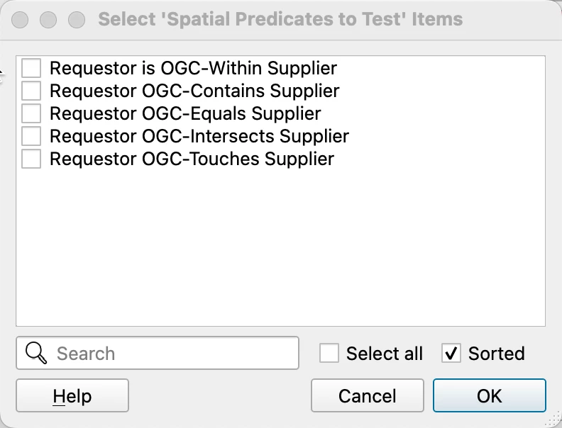

  • You could use the Tester to test for an expression such as If A(Area) = 50% of A(Area) to see if they are split parcels
  • You could use the SpatialRelator and the different ‘spatial predicates to test’ could be your different types of change

My first thought for splits and/or merges would be a spatial realtor between the Inserted and Deleted port, Parcels that have been split will have multiple inserted parcel relationships to 1 deleted parcel, and Merged will have the opposite.
Boundary changes could be detected through comparing vertices, or geometry string values. extract the values and compare. Or differences in area, perimeter etc.
An AreaOnAreAOverlayer could give those parts of the polygon that are not shared with both so you can identify the where the polygon changed, if that is a requirement
