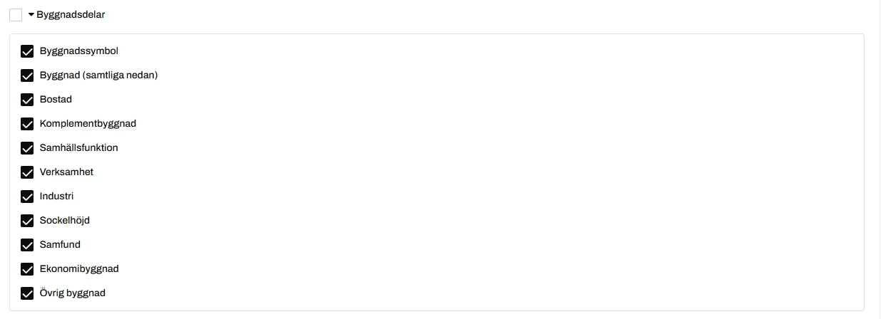

I have created a bunch of User parameter type: Groups Box in a skript. Within those Group box are a bunch of parameter type: yes/no. These parameters are used in an FME Flow APP. However. They’re not working as I want them to work. When a Group box is unchecked in the FME Flow APP then I want all the layers inside the group box to get unchecked.
However in FME APP, it doesnt do that. Please see picture below attached to this question. All the layers inside the Group Box (byggnadsdelar) are still checked. What am I doing wrong?

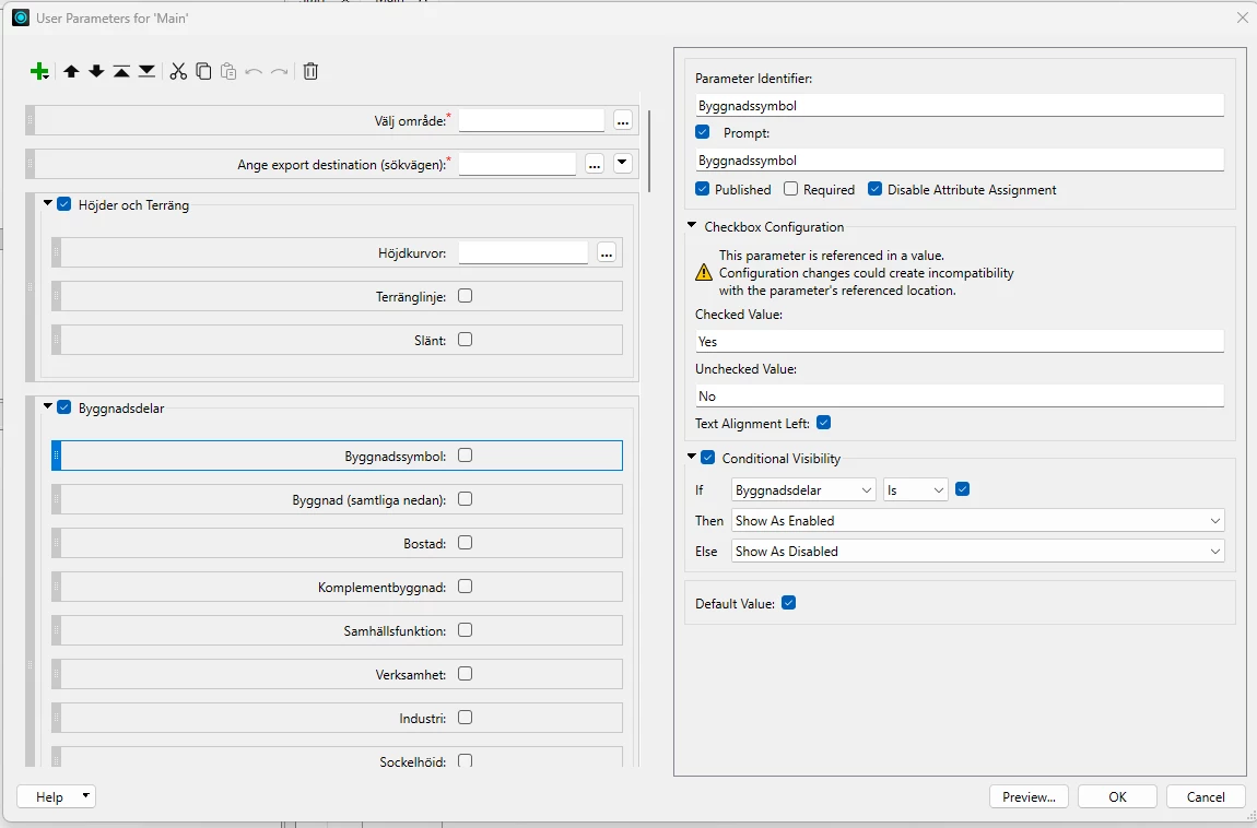

Please see my konfiguration for the group box parameter and the yes/no parameters inside Group Box.

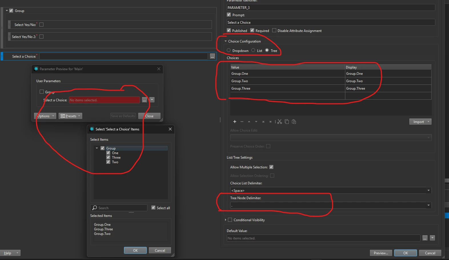

I think you maybe want to try a different parameter type.
Maybe try the “Choice” type and build a choice tree which would allow you to select and unselect groups. See below.
This is how your parameter choice would look.

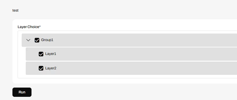

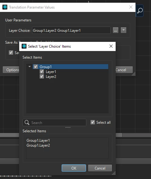

  • Oct 28, 2025 2:43 PM UTC
This is how it would look in your app.

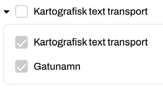

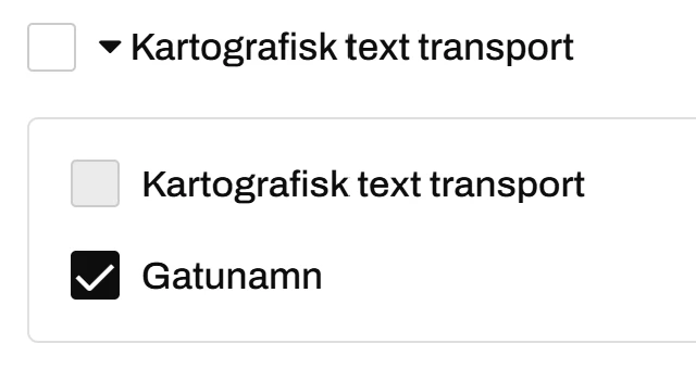

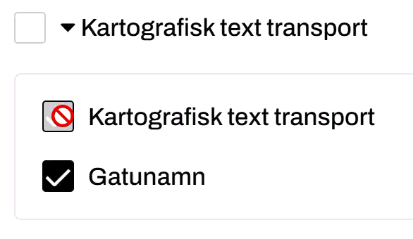

I apologize for the confusing user interface. In FME Flow 2024.2, deselecting a group actually does disable parameters within the group, it just isn’t clear until you hover over the checkbox. You can see in my GIF below that it looks like the parameters are still checked and active, but when I hover my mouse over them, it shows that I cannot edit them. In other words, they were successfully disabled. I can only edit the parameters within the group once the group’s parent is set to true.
This is clearer if you deselect the group while one of its child checkboxes is set to false. You can see this has greyed out the checkbox, making it much clearer that this parameter was disabled.
I added a logger to the workspace and after running this job in FME Flow from a Workspace App, both the “Kartografisk text transport” and “Gatunamn” parameters are shown to as “<Unused>” which is consistent with what is shown in FME Form’s translation log. The group’s parent parameter will show a value of “No.”
In contrast, if the group were checked (enabled), the group’s parent parameter will show a value of “Yes” and the child parameters “Kartografisk text transport” and “Gatunamn” would show as “No” and “Yes” respectively in the log.
In FME Flow 2025, whether or not the parameters have been disabled are much clearer in the Workspace App UI. You can see the checkboxes are greyed out even when they’re still checked instead of remaining fully black.

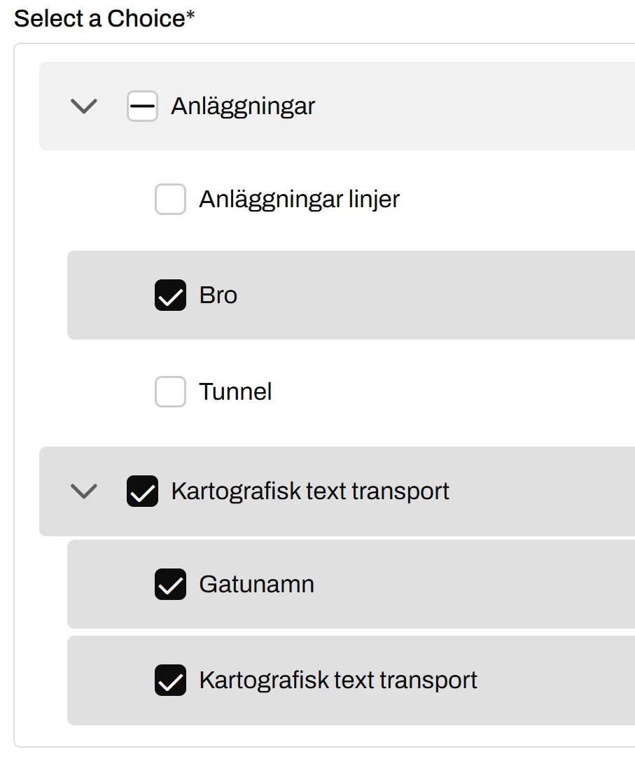

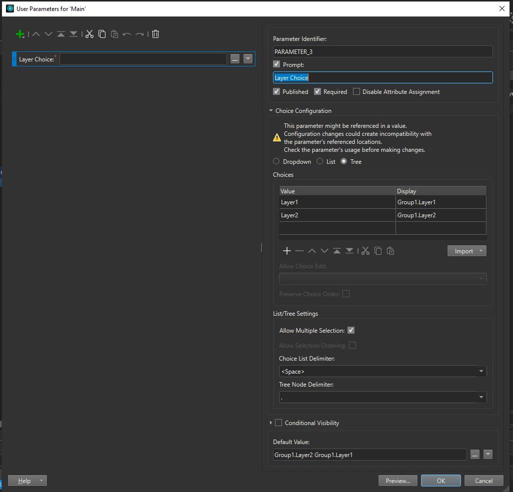

If you want to move forward with the choice tree to make things clearer for your users, you can speed up choice tree creation by creating a JSON document with all your group and layer names that you can Import to the choice tree.
Example JSON file contents:
"Kartografisk text transport": {
"Kartografisk text transport": "choice",
"Gatunamn": "choice"
"Anläggningar": {
"Anläggningar linjer": "choice",
"Bro": "choice",
"Tunnel": "choice"
In your choice parameter, under “Choice Configuration,” select Import/From Dataset… and pick your .json file.
Then, click Next. Import Mode/Import From should be set to “Attribute names,”  then select the JSONFeature.
On the next screen, Select All for Value and Display, and for Import Order choose “Preserve Reader Order.”
The result will look like this in your workspace app:
