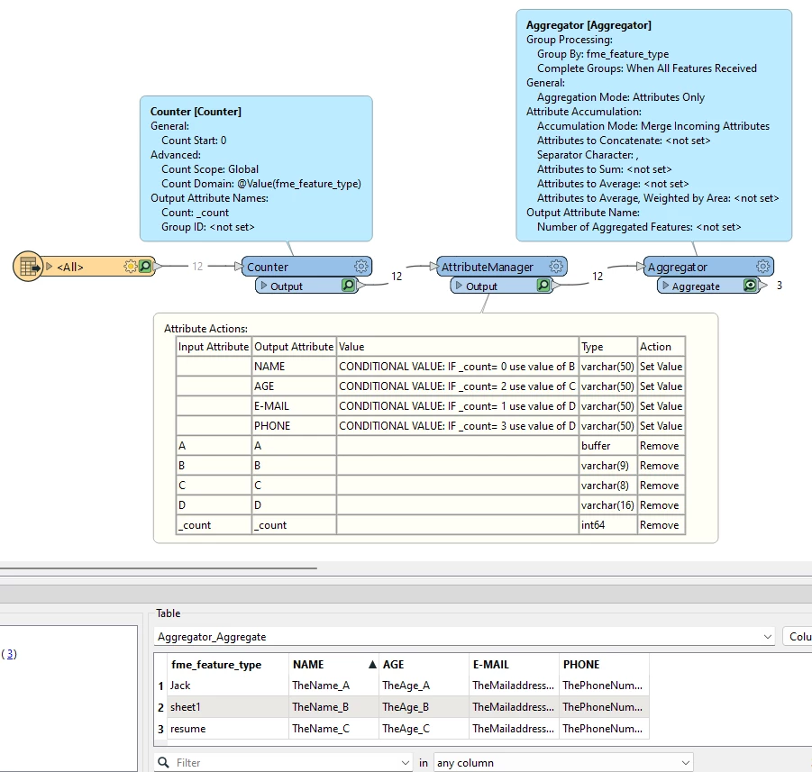

Usually, a single line on an Excel sheet is a complete feature.
In this case, several lines of the sheet contain informaiton over one feature. Luckily, the position of the relevant elemants on the sheet is constant.
So this is not very basic functionality in FME.
You can trick the Excel reader into reading all sheets, by disabling the sheet name in the reader. This will add fme_feature_type as an attribute, containing the name of the sheet.
When all sheets are read, add a _counter, let the counter restart when fme_feature_type changes.
Now you can use an AttributeManager with a conditional value: for a certain _counter use the value of a certain attribute.
Finally aggregate on fme_feature_type, merge the incomingattributes.
I hope the attached example works, it should contain sample data.
