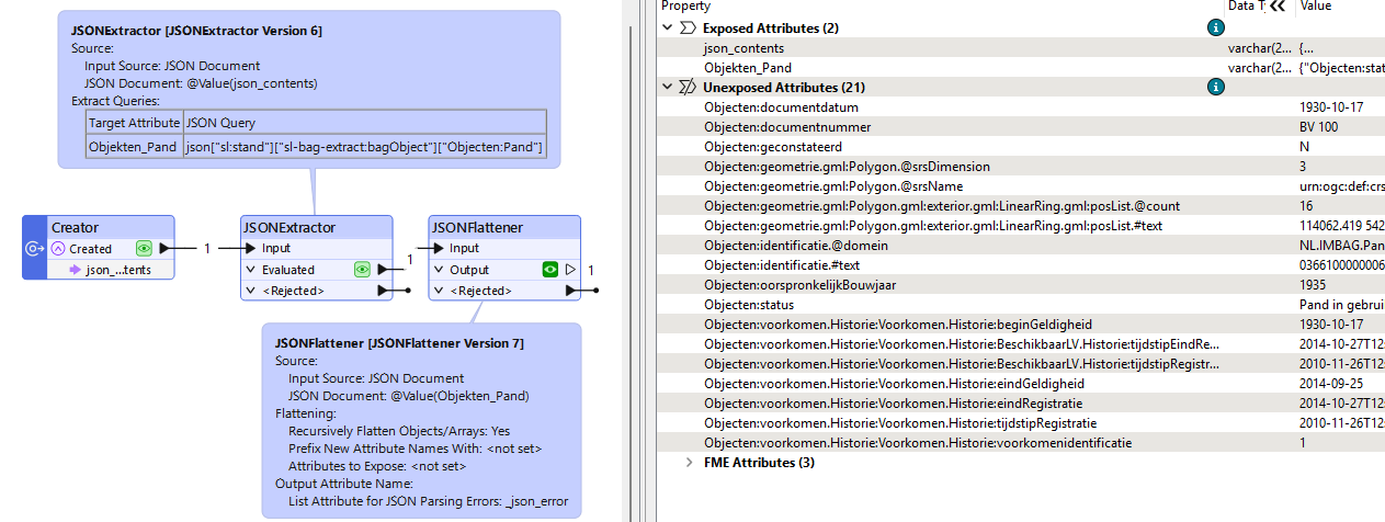

It depends on what info you want exactly.
Transformers generally used for JSON extracting:
  • JSONExtractor
    • Extract specific portions to attributes.
  • JSONFlattener
    • Flattens objects, extracting keys and values to attributes. You will need to expose these attributes as they are unexposed.
  • JSONFragmenter
    • Extract specific portions to features.
david_r
  • May 13, 2025 10:12 AM UTC
Try a JSONExtractor followed by a JSONFlattener:
Remember to expose the attributes you need in the JSONFlattener.

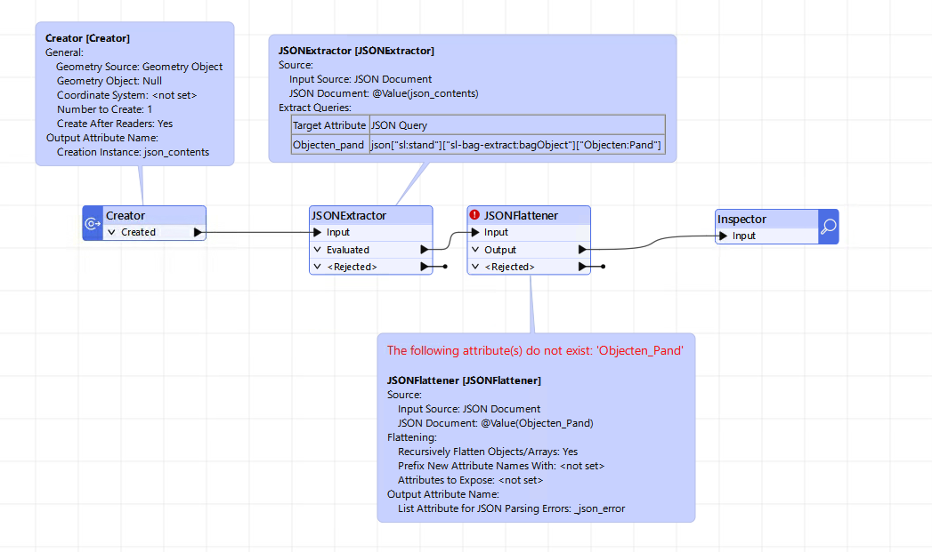

Thanks for the help, i'm still don't get there.

Attached sample workspace.
One quick remark: FME is case sensitive when it comes to attribute names. So you have set Objecten_pand in the JSONExtractor but then refer to Objecten_Pand in the JSONFlattener
