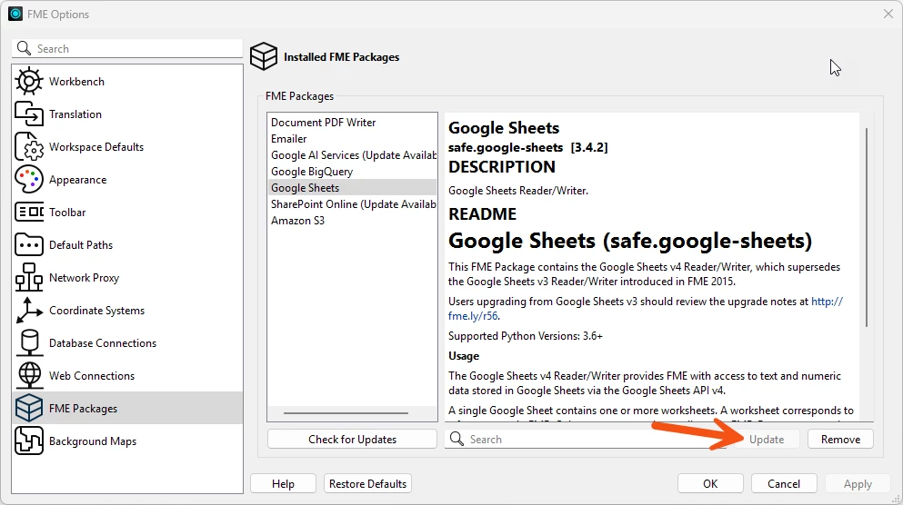

I’m curious if those would work for you. I also looked into the packages dialog. I also didn’t get a notification to upgrade my package, but it looks like I was already updated to the current version.
When you go into FME Packages and Google Sheets, is the Update button also grayed out?
It’s still possible there is a bug or enhancement but with more information from your set up we would get a clearer picture!
@desiree_at_safe thank you for following up! I re-upgraded to 2025.1.2 from 2025.0.2, checked all the places you indicated, and now it works great. I’m not totally sure what went wrong the first time I tried the install, but everything seems to be working great for me now. Thanks again!
