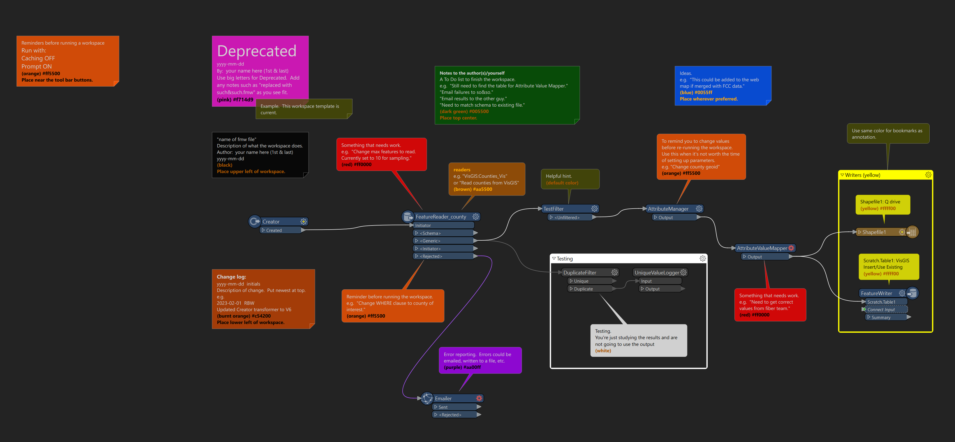

We annotate a lot, both for sharing and recall, using standardized colors for balloons and bookmarks.  Here’s the cheat sheet that everyone follows:
Annotation colors

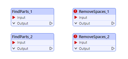

An approach like that is good, it’s when it gets renamed to ‘PostGIS’ or ‘Excel’ it becomes a problem. Especially in cases where you no longer know what the transformer is just by looking at it.
For example:
I have a HoleCounter, VertexCounter, AttributeCreator and AttributeTrimmer here - which is which?
