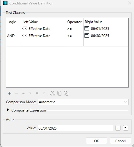

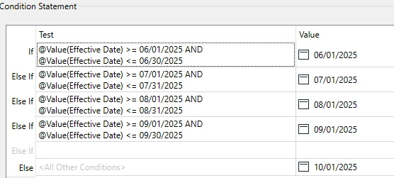

Hi,
I am trying to manipulate the dates based on the logic.
If the effective date falls between 06/01/2025 - 06/31/2025, then the date of inception should be 06/01/2025 and the similar rule applies for the month of july, aug, sept.
And if the effective date is anywhere between 10/01/2025 - 10/01/2026, then the date of inception should be 10/01/2025.
The issue here is :
If the effective date is 08/20/2026 → Inception becomes 08/01/2025 ( Expected is 10/01/2025)
The similar issue is observed for months of june, july, aug, sept  for year 2026.
I am surprised here why FME would not pick up the year from the date

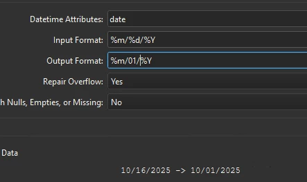

There is a comparison mode of Date/Time in the tester but it expects FME format dates.
If you look in the warnings you should see something like
Tester (TestFactory): TestFactory: Unable to do a date/time comparison of '20/08/2026' and '01/09/2025'.  Comparing as strings instead.
If you just want to create a date of inception as the first day of the month the date falls within, I would do something like this in a DateTimeConverter

mm/dd/yyyy (e.g. "10/01/2025") is a date format specific to some regions, FME won't consider dates representated by such a regional format as date values. The reason for the issue you observed is that FME compares the dates represented by mm/dd/yyyy as text strings, i.e. "08/20/**** < 08/31/2025" is true regardless what **** (four characters) is.
If you woud like to compare two dates with a comparison operator (<=, =>, etc.), consider formatting the dates by standard FME date format (yyyymmdd, e.g. "20251001") beforehand.
