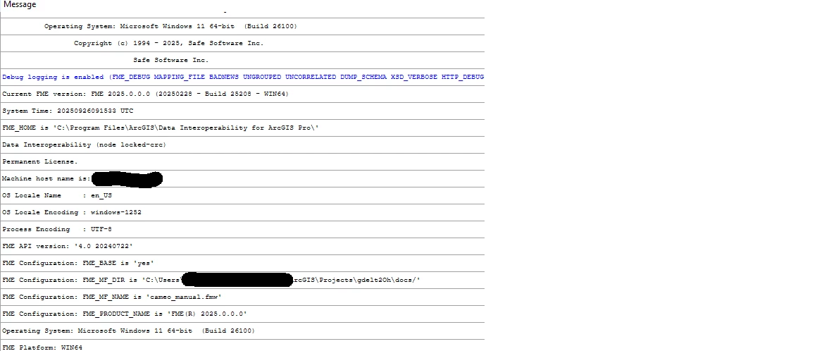

For the python error, please run your workspace and show a screen capture of your translation log. Below is mine using a random workspace.
