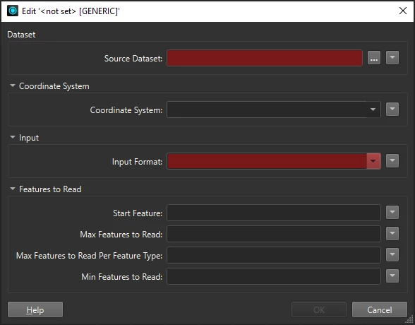

So we have a FME Flow set up on a Microsoft Azure machine that is causing some problems for our Spanish and German colleagues. More specifically that when their data (mainly KML’s) that contains one of their local language characters is being sent through our Flow tools then the process fails due to “invalid byte ‘local character’ at position 1 of a 6-byte sequence’.
Due to the fact that our users are using diverse data formats then most of our Flow apps use generic readers where they select the format of their input data in a published parameter dropdown that is then feed into the “Input format” of the reader. We are not allowing the feature reader to figure it out itself due to limitations of GeoJson’s and GML’s.
So far I cant see that you can change the character encoding parameters in the Generic reader like you can in specific readers, such as the shapefile one (correct me if I am wrong). So I have instead tried to change the Regional settings of the server machine to Latin (both with enabled “Beta: Use Unicode UTF-8 for worldwide language support” and disabled aswell), but to no prevail.

Firstly, the generic reader in FME Form (Workspaces) supports changing encoding for certain formats, but the option to specify encoding depends on the underlying format you select within the generic reader. For example, text-based formats like CSV or TXT often have an "Encoding" parameter in their reader settings., any Generic format removes the option to specify encoding on the reader.

In regards of the first part then I’m not sure where those encoding parameters you mention should be in a generic reader?

Yeah only formats like CSV, database, shape file… have parameter options for encoding.I suspect the formats you are converting don’t have options to change the default encoding. You can read up about https://docs.safe.com/fme/html/FME-Flow/AdminGuide/Configuring_Character_Encoding.htm This required going into the flow machine and Open the web application's deployment descriptor web.xml file, make changes as per the help
