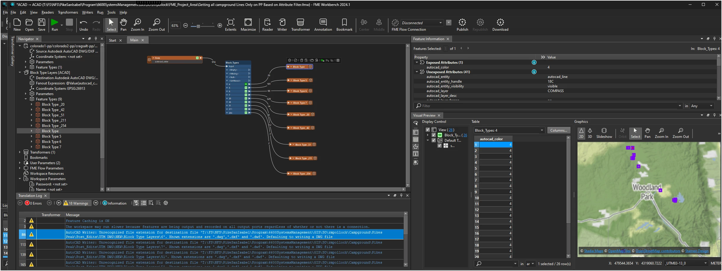

Hi,
I need help how to use Fanout and not sure if this is a bug or not.
Using Workbench 2024.1.1
  1. Using DWG as a reader and then change the parameter to Geometry and selected lines.
  2. Add the AttributeFilter to import the feature cache type
  3. Add the data as a writer to write new feature name.
Am I doing something wrong or need some tweak work ?

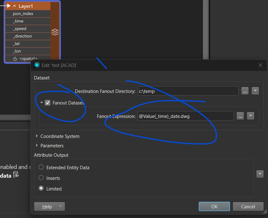

Hi ​@probert1968
Are you trying to read a dwg with all the layers and then write out the geometry types or layers to another file format, like shapefile or features in a filegeodatabase? Fan out can be used on the writer in the screen captures below: (I used a an autocad writer but does not have to be)
The variable attribute is used to “Fanout” the file names and thus separate the content into different files. Hope that helps!!

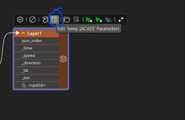

Hi ​@probert1968

​@crutledge   yes
That work !
