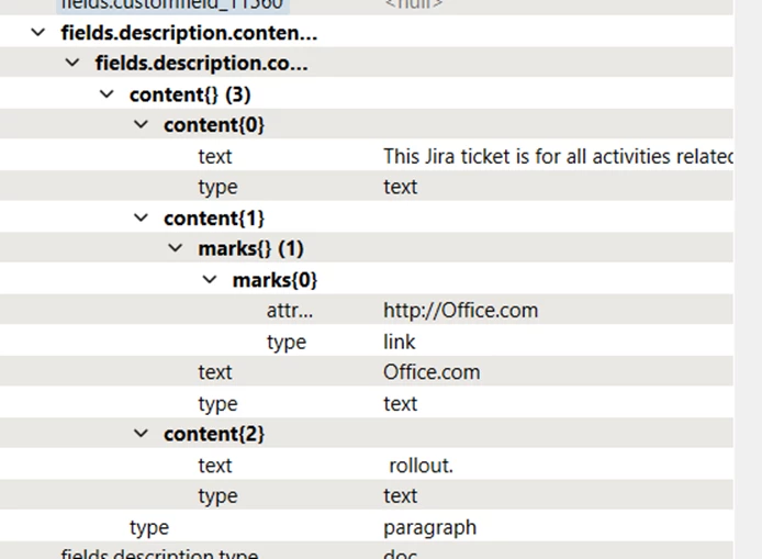

I have a a workflow exracting data from an API. I have got almsot everything I need from the JSON but need to get as single description field. The JSON structures breaks the description into sever parts all nested within the description part. The number of parts varies by feature.
I essentially need all the text elements in the image below

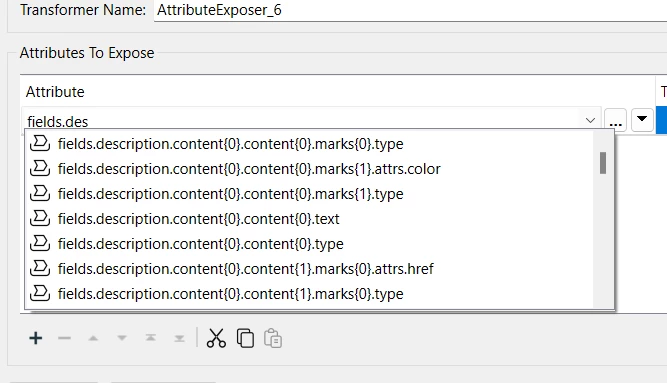

When I use a JSON exposer it asks me to specificy each indexed element, but I do not know how many there will be in any given feature
I imagine there is something really obvious I am missing here

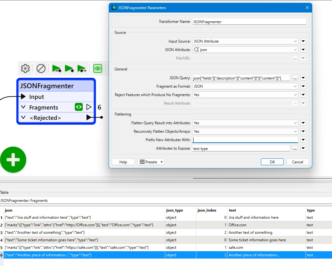

You’re almost there…
Try the JSONFragmenter, it works better for nested JSONS than the JSONExtractor
Dig into the nested structure with a JSON Query using the wildcard [*] - works multi levels.
Expose the desired attribute names and you’re all set.

I think I have done what I need using the last method then concatenating using an aggregator.
