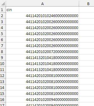

Looking at the excel sheet you attached, Excel is displaying the values in scientific notation. You can format the cells as Number and change it to 0 decimal places and they’ll appear like so:
I also tested setting the output attribute type in the writer to string and that worked (without needing to change the cell format in excel)

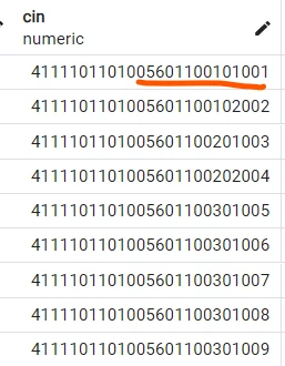

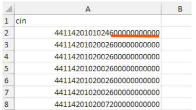

​@hkingsbury The challenge here is that the remaining code is turned to zeros (0)
I will want it to appear in full, just like what I have on the cin column on database. Check the image below.

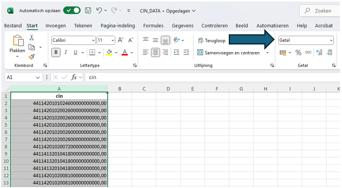

Hi ​@evoteck, lets see whether I can give you some support. The fastest way to solve this can be done in Excel itself I guess.
Steps:
  1. Visit your Excel data again
  2. Select your column with data completely
  3. Select the type of data this column should be
  4. Choose Number
    In my Excel it shows Getal which is Dutch for number

​@lambertus Changing it number is what ​@hkingsbury did earlier, but that will change other part of the numbers to zeros (000000), which is not the same with the actual figures from the database.

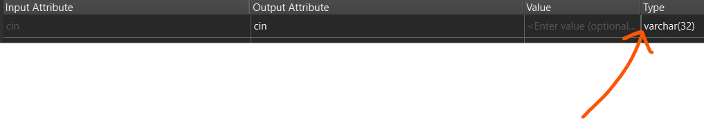

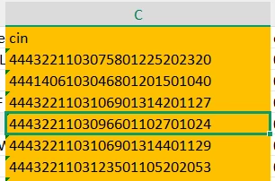

​@lambertus and ​@hkingsbury  I was able to solve the issue using Attribute Manager Transformer to change the data type for the cin, to accept large numbers .
And the output in excel is showing correctly
