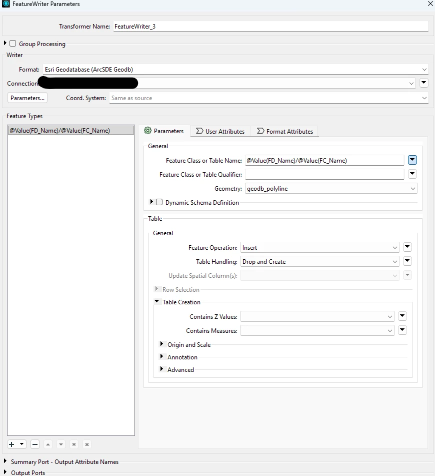

i am using an Feature Writer to write Feature classes in an Feature Dataset in an EGDB.
I found out that i need to enter the Feature Dataset Name/Feature Class Name hardcoded. For Example: FeatureDatasetName/FeatureClassName descriped in the following picture:
SDE Feature Writer with hardcoded (static) Feature Dataset and Featureclass Name
An dynamically generated Value like “@Value(FD_Name)/FCName” or even the whole value @Value(FD_name_and_FC_Name) is not working as Feature Class.
How i found that out? The Features get inserted in the Feature Class, even if i set Table Handling to drop and create. When i use the hardcoded (static) Feature Dataset and Featreclass Name the Table got dropped and created new, so it was working as expected.
SDE Feature Writer with dynamic/Attributvalue Feature Dataset and Feature class Name
When i use log level debug and use the dynamically (attribut value) Feature Dataset and Feature class Name, i get the following error Message which i dont get when i use the hardcoded (static) Feature Dataset and Featre class Name:
BADNEWS: File C:\Program Files\FME\metafile\MULTI_WRITER.fmf could not be opened
(D:\code\fme\source\engine\core\control\generiz.cpp:1630) class StatusInfo __cdecl STFGenericizer::processMetafile(const class stk::ex::UString<0> &,const class stk::ex::UStringArray<0> *,const class stk::ex::UString<0> &,const class stk::ex::UString<0> &,const class stk::ex::UString<0> &,const class stk::ex::UString<0> &,class STFAttributeName &,class STFMetaMapper &,class STFObjectNameConstraints &,bool &,bool &,bool &,class stk::ex::UStringArray<0> &,class stk::ex::UString<0> &,class std::vector<class STFFeatureType,class std::allocator<class STFFeatureType> > &,class stk::ex::UStringArray<0> &,class stk::ex::UStringArray<0> &,class stk::ex::UString<0> &,class std::vector<struct std::pair<class STFAttributeName,class stk::ex::UString<0> >,class std::allocator<struct std::pair<class STFAttributeName,class stk::ex::UString<0> > > > &,class stk::ex::UStringArray<0> &,class std::vector<class STFAttributeName,class std::allocator<class STFAttributeName> > &,class stk::ex::UStringArray<0> &,class stk::ex::UStringArray<0> &,bool &,bool &,class stk::ex::UString<0> &,class stk::ex::UStringArray<0> &,class STFObjectNameConstraints &,class stk::ex::UString<0> &,class stk::ex::UStringArray<0> &,class stk::ex::UStringArray<0> &,class stk::ex::UString<0> &)
I'm wondering whether this is expected behavior or a bug when using dynamic attribute values for the feature class name?
I am using FME(R) 2024.0.1.0 (20240328 - Build 24202 - WIN64).

In your concatenated FD_FC_name attribute, is there a forward slash in between? If I want the Feature type (Feature Class) name to be dynamic I would rather have the dataset and the feature class in separate attributes with a forward slash in between.

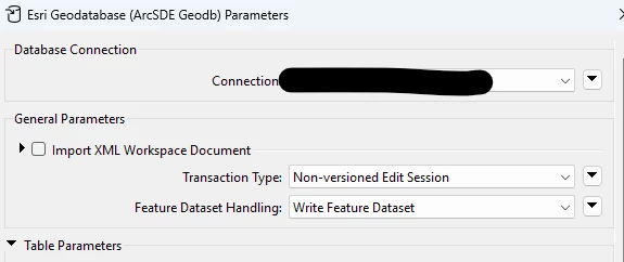

What is the Feature Dataset Handling parameter on your feature type?
Yes there is a forward slash betweeen the Feature Dataset Value and the Featureclass value.

That is my Feature Dataset Handling parameter:
When i set this to Off - Slahes becomes underscores FME writes it to the root of the EGDB and not into the Feature Dataset.
