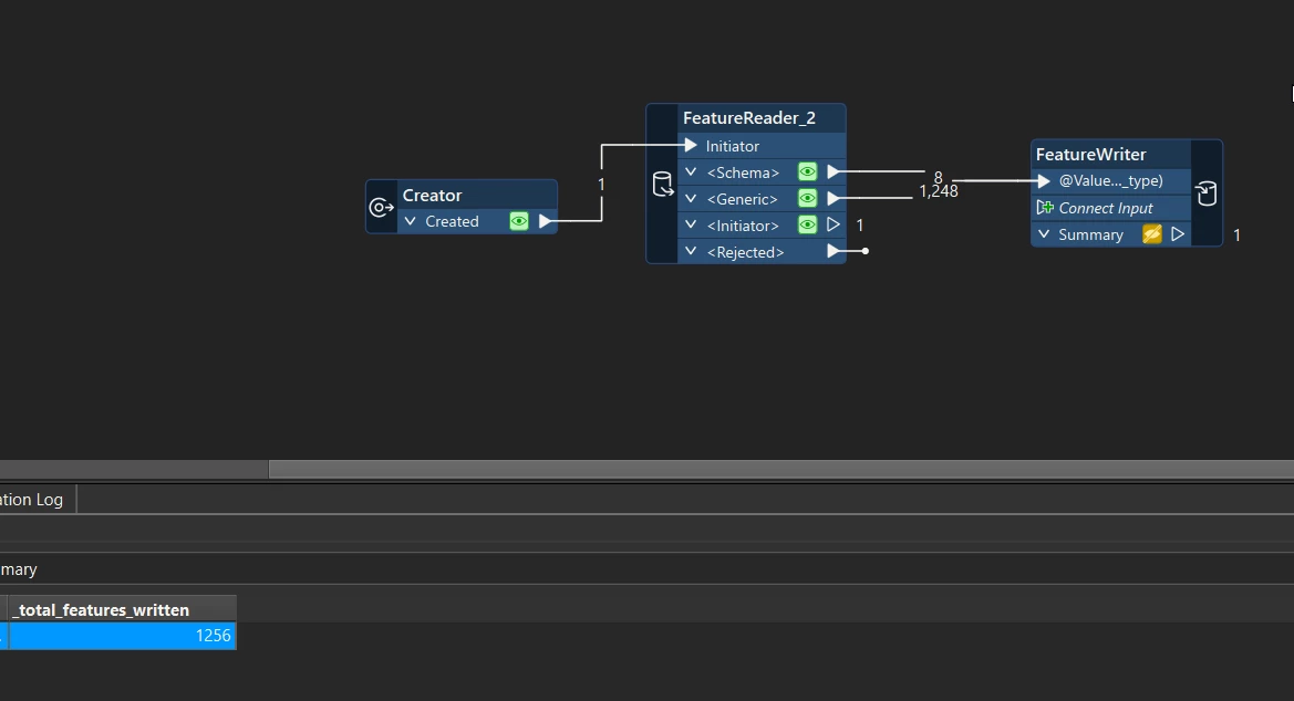

I’m able to write dynamically to a file geodabase using the GEODATABASE_FILE writer with the following setup
However, trying to do the same in a FeatureWriter fails with a cannot define schema error
Same behaviour seen in both FME 2024.1 and FME 2025.1
Is this a known issue?

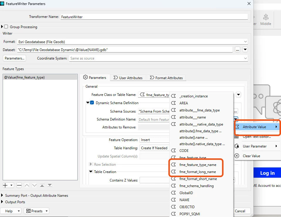

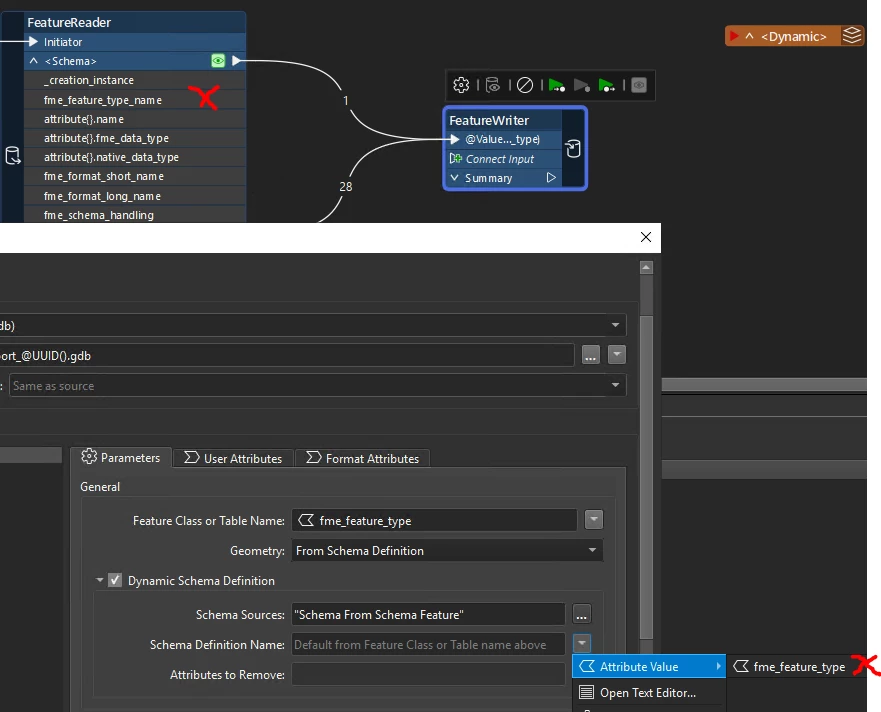

If i try to set schema definition name to fme_feature_type_name in the Feature Writer it’s not possible, only fme feature_type is available for selection
The only way i can seem to get the FeatureWriter writing dynamically to a File geodatabase is by adding the schema attribute to all features

I think you don't need to define fme_feature_type_name or any column of your schema feature. This parameter is for your data features attributes.
Doesn't it work with fme_feature_type selected ? Can you share the full log ?

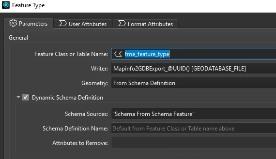

The FeatureWriter is set up with Schema Sources as Schema From Schema Feature and Schema Definition Name as Default from Feature Class or Table name above
It returns this warning
Cannot define schema for ‘xxxxx' as the feature does not contain schema information, and schema source is set to 'Schema from Schema Feature'. Please verify writer feature type configuration
Followed by these errors
Esri Geodatabase Writer: Feature Type Definition xxxx' was requested, but not defined. Please visit https://www.safe.com/support
GEODATABASE_FILE writer: An error has occurred. Check the logfile above for details
The exact same set up using a writer works without issue.
If i switch the FeatureWriter to Esri Geodatabase (ArcSDE Geodb) that also works without issue

I tested a simple workspace locally and it appears that the attribute “fme_feature_type_name” attribute exists.
I am not entirely sure what is happening since ArcSDE also works as expected.
Are you able to share your workspace (no need for data)?
Can you try creating repeating the process in a brand new workspace?

​@rahulsharma - the workspace is literally as posted in the screenshot, a feature reader followed by a feature writer
