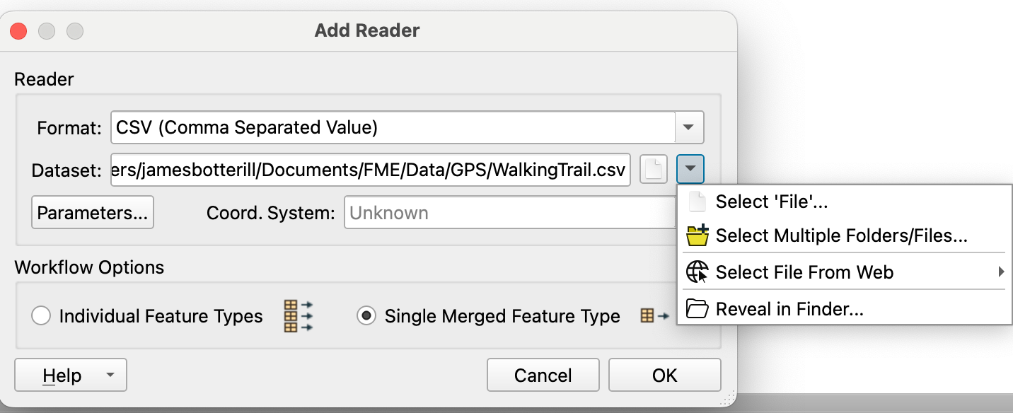

So you want to read up on Merging / reading many datasets at once
https://docs.safe.com/fme/html/FME-Form-Documentation/FME-Form/Workbench/Merging_Similar_Datasets.htm
Add CSV reader and click on the “Single Merged feature type”

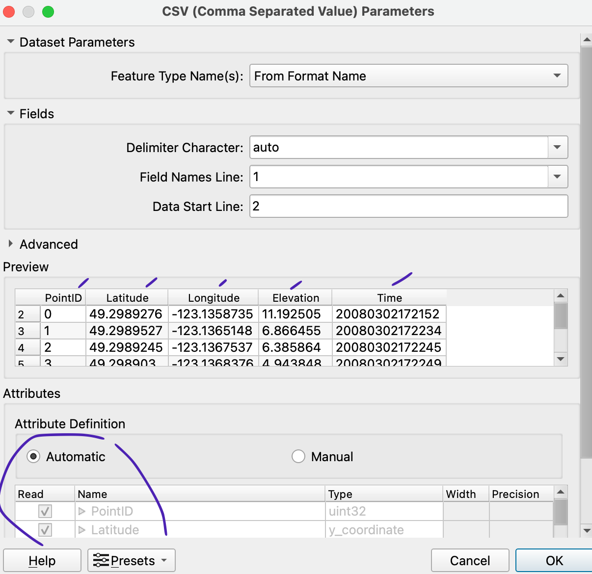

Be sure to always go into reader parameters. NB. by automatic it will read each csv schema separately. So what I mean here is, you assume all csv’s have 5 columns named exactly as per the preview
If they are named something else, then you will need AttributeExposer followed by AttributeRenamer for example

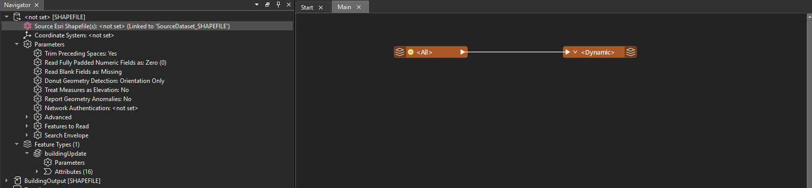

My only question is how i get reader like this but instead of Shape reader, i want CSV reader
Because for this shape reader i dont have to enter source file to read, because flow tells it what file to read
I need exactly like that , just with CSV type
