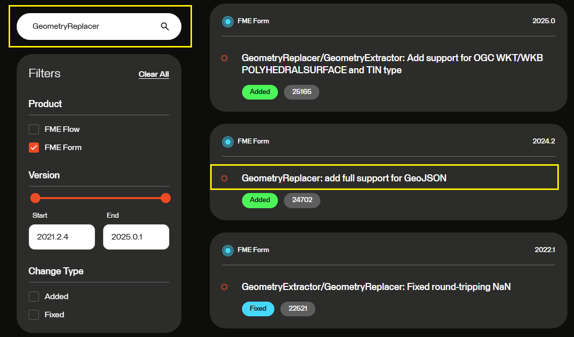

Hi ​@mattebridges ,
We’re on 2023.1 - so nothing ancient.
Originally GeometryReplacer (Geometry Encoding: GeoJSON) only supports replacing a “geometry” object with a geometry, not support replacing full GeoJSON document.
However, GeometryReplacer in FME 2024.2 or heigher supports replacing full GeoJSON document. You can find when the enhancement has been introduced in the Change Log, linked from the FME Downloads page.
Change Log - Result of Search "GeometryReplacer"

Hello ​@takashi - thank you so much for taking the trouble to explain this.
I’m relieved to know there was a reason why I couldn’t get the GeometryReplacer approach to work.
