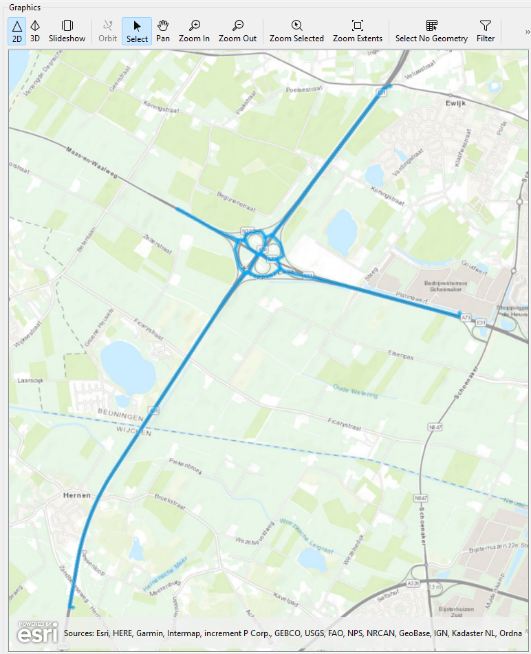

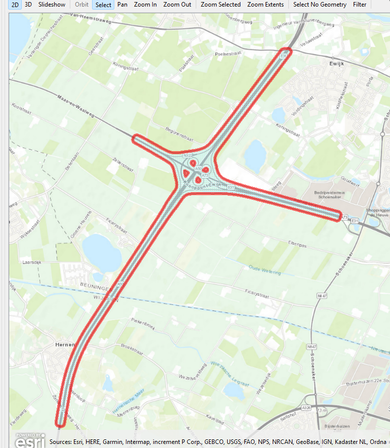

I want to create centerlines on highways. Now, long lines, without intersections, work fine. However, i get wrong results when fme encounters a intersection, like in the pictures below. I expected this and tried to solve it, but it only became worse.
Does anyone know a right way to do it?

Unfortunately that kinda is what the CenterlineReplacer does… Do you want the individual ramps as well as the main roads? (if you don’t want the ramps, perhaps dropping the donut holes before the CenterlineReplacer could make a difference)
Thinking out of the box here… since it’s a Dutch example:
Road centerlines are available as open data, you could get those and then use your polygons to do a spatial select.

Thanks for your answer! Yes, i want all of them. I tested it before, and the donuts are a solution for the main highway. But i also want the ramps.
Yes, i did try working with the open data. Which one can you recommend? I already did try the NWB - wegvakken , but that layer isnt that precise in the opinion of my college.
Thanks in advance! (Dankjewel ;) )
