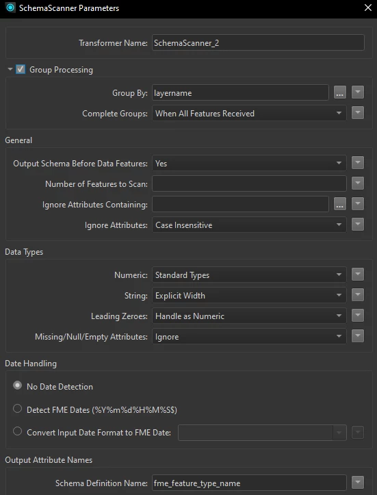

I’m trying to generically read some tables and distribute them into different DWG Object Data layers. For this, I have a mandatory attribute containing the output layername.

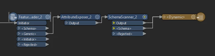

I use a SchemaScanner with a Group By on this attribute to generate the schemas and finally write everything using a dynamic DWG Object Data Writer.

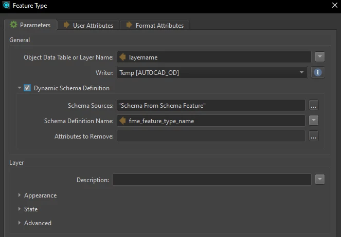

But it doesn’t work, I get a Layer 'XXX' is not defined
But(bis) if I use another DWG writer (e.g. RealDWG) with the exact same configuration, it does work.
I guess the difference comes from the Object Data table definition? But I have no idea how to do that.
I’ve tried to sort schemas and features to make sure that the schemas arrive before the features but it doesn’t change anything.
When using the RealDWG Writer, if the parameter Output Schema Before Data Feature is set to No, I get the same error, but once set to Yes, the file is written without problem.
What should I change when working with a AutoCAD Object Data Writer?

Process overview

I’ve found it’s often been an issue between a mismatch in the fme_feature_type_name and the layername. You need to make sure that your “layername” and fme_feature_type_name are the same. Any you should make sure that you schema feature also have the layername attribute.
I’ve found that this behaviour it a little inconsistent between formats. I must admit I don’t think I’ve tried it with the AUTOCAD_OD froamt though, so it could definitely be an issue with the writer.

Thanks for your quick answer! It does seem to be something like this, but the cached data doesn’t show any difference between the two. However the error says Layer 'MY_LAYER' is not defined while my attributes  “layername” and “fme_feature_type_name“ are my_layer. But it feels more like a logging thing than the problem here.
In the meantime I’ve tried a workspace from scratch (generic feature reader and Autocad OD writer with schemascanner) and I don’t get this problem, so at some point I introduce something in my other workspace, I just need to figure out what.
While writing I fiddled around and I think I found the problem; a fanout on the output filename seems to introduce the error.
