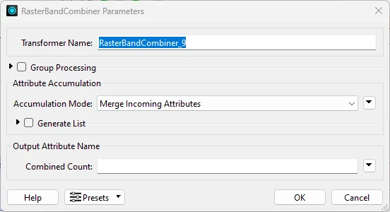

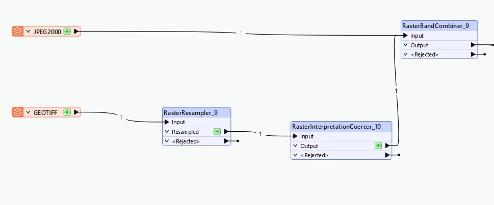

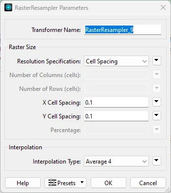

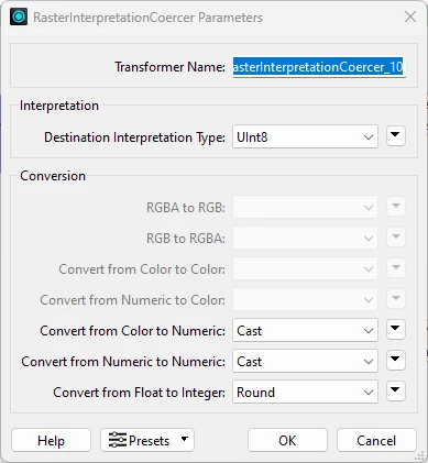

My workflows looks like this:
with following settings
Unfortunetly there are some pixels where values get lost, so when I add an RasterBandAdder, there are holes in it.

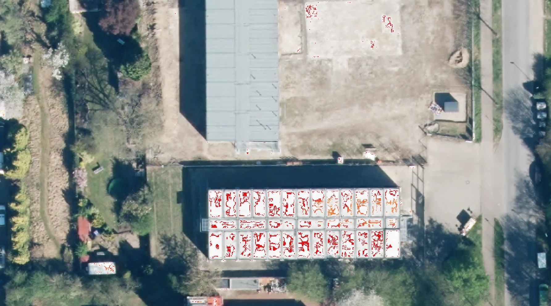

This is a picture of the combination of DOP + DSM. The underlaying raster (red) is the DSM.

What are the values of all bands on the location of the red area's?
Looks like the area is pure white. That would be 255.255.255. Probably 255 is the NoData band as well.
