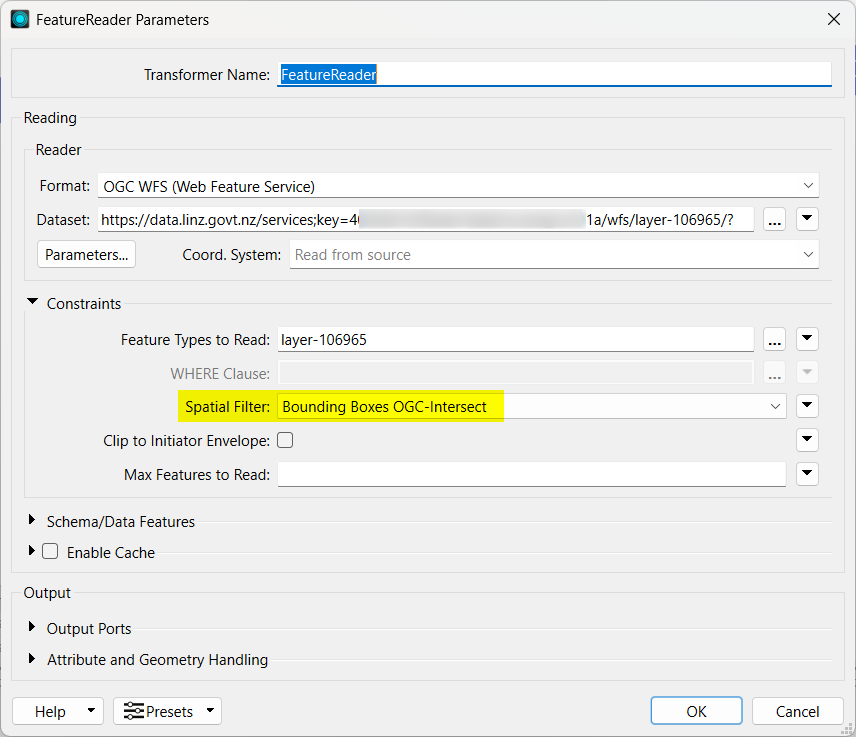

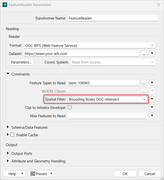

Take your BBOX-coordinate values and create a BBOX-geometry by using the 2DBoxReplacer-Transformer. If you already have a geometry, please replace it by the BBOX.
Then send the BBOX-geometry to the FeatureReader. In FeatureReader Constraints please set Spatial Filter to “Bounding Boxes OGC-Intersect”.
Spatial Filter: BBOX
FeatureReader fetches the BBOX-coordinates and integrates them into the WFS request.
You may verify this by having a look into the Translation Log, please search for <WFS> GetFeature URL.

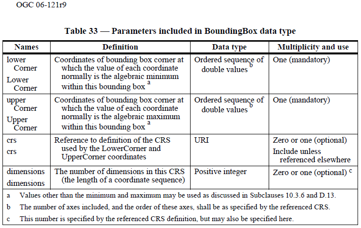

According to OGC Web Services Common Standard and the WFS Standard, the BBOX can be passed KVP (Key Value Pair) encoded as part of the service URL like this:
/wfs/layer-106965/?service=WFS&BBOX=xmin,ymin,xmax,ymax
Please replace xmin etc. by your coordinate values.

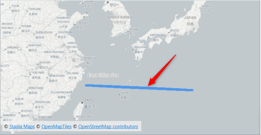

First conspicuous feature:

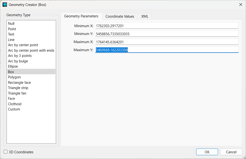

5458856.7335033035,1762303.2917200956,5460668.162203304,1764145.6364200956

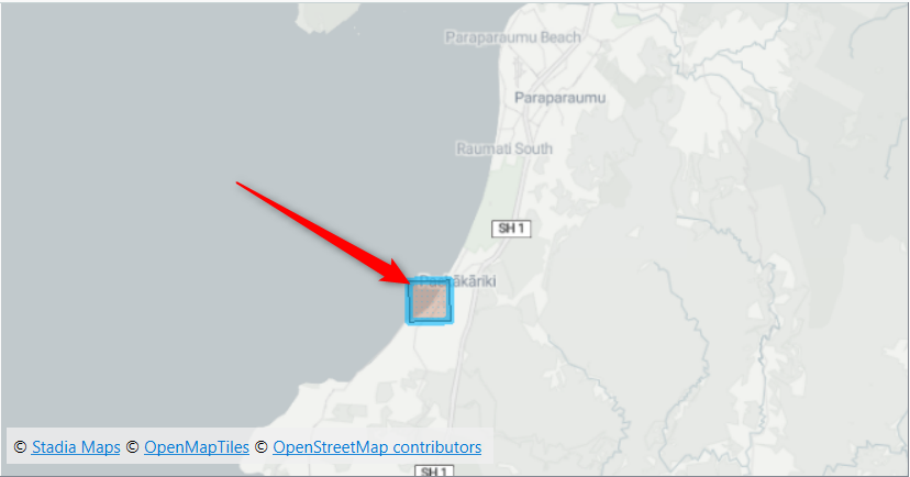

It seems to me that your coordinates shown above (in your screenshot) have the wrong range sequence (YMIN,XMIN,YMAX,XMAX), if they are in EPSG:2193?
When I display it, the BBOX looks like this:
Wrong order of coords?

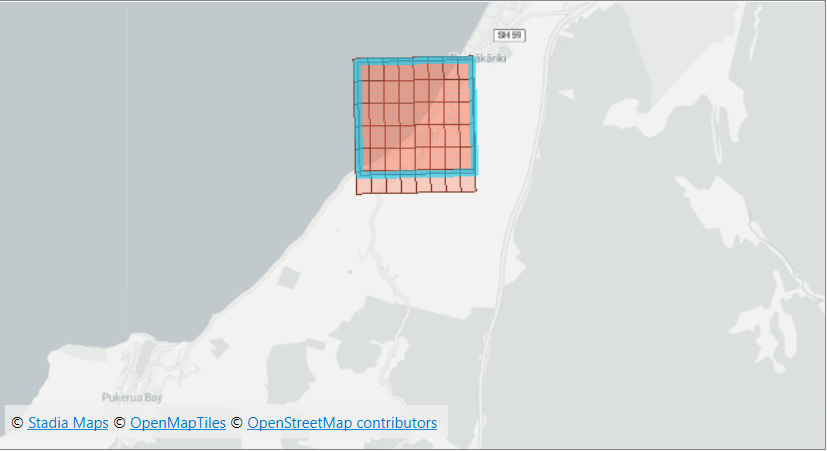

If I reverse the order of the coordinates, I get this BBOX.
X and Y swapped
Maybe the BBOX you wanted?
I assume this was your intention?

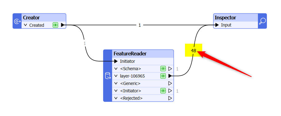

If this is the case, then [Bounding Boxes OGC-Intersect] also works as expected in FeatureReader.
I get 48 tiles.
Built-in BBOX filter
Result: 48 tiles
