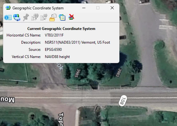

Is FME able to read the MicroStation DGN file geographical coordinate and use this information when creating esri geodatabase features?  I see several tutorials and methods that seem to suggest CAD data such as DGN (MicroStation Design Files) do not contain geographic Coordinate systems but is not totally true.  Design files do or can have coordinate systems, and most do when relative to Transportation Civil Engineering Design.

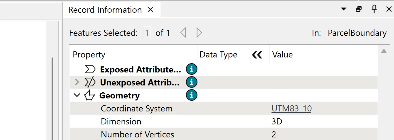

FME can read coordinate systems from DGN as long as the coordinate system has been set in the original DGN file.
After reading the DGN file, look at the record information (or feature information depending on the version you are using) on the right side of the workspace, the coordinate system information will be under geometry.

OK thanks I will look for that Value.
