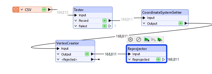

My workflow looks like this:
CSV → Tester → VertexCreator → CoordinateSystemSetter → Reprojector
  • In VertexCreator I assign X = stop_lon, Y = stop_lat.
  • In CoordinateSystemSetter I set the source coordinate system to EPSG:4326.
  • In Reprojector I reproject to EPSG:7856 (GDA2020 / MGA Zone 56).

Try swapping the order of CoordinateSystemSetter and VertexCreator. I find FME accepts the CRS set operation better if there is a geometry on the feature.

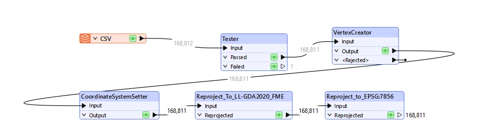

Another thing to look at then is the reprojection process itself.
Transformations involving MGA2020 can be tricky. Try a multi-stage reprojection such as: LL-WGS84 > LL-GDA2020 > MGA2020-Z56 or even LL-WGS84 > LL-GDA94 > LL-GDA2020 > MGA2020-Z56.
Also the use of the CSMapReprojector can give you a little more control.

Thanks so much, it worked!
I really appreciate the help. I’ll share my workflow here in case it’s useful for anyone else who runs into the same issue.

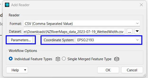

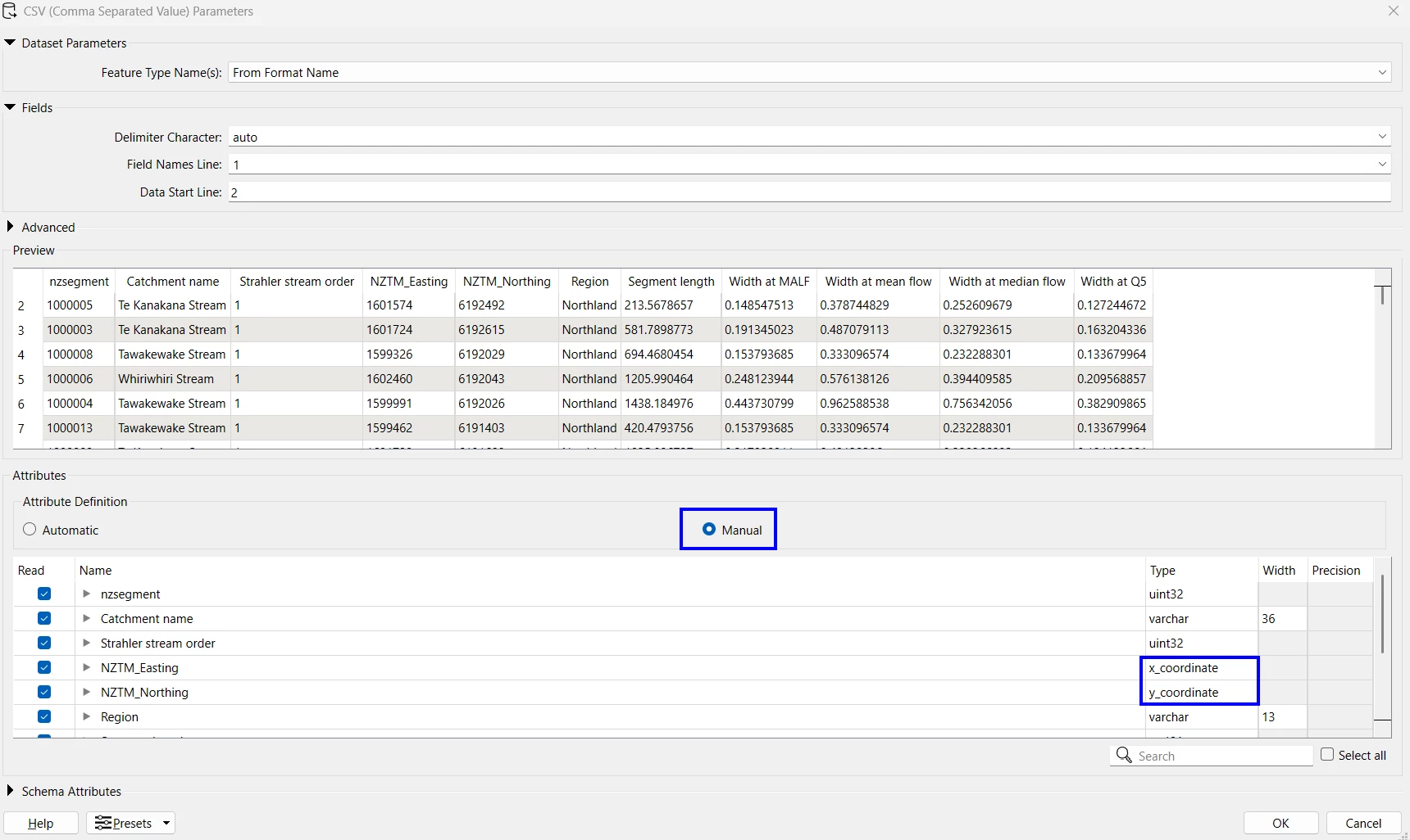

Firstly define the two fields as X and Y coordinate fields and then also their source coordinate system in the reader, so they come out as spatial features.  You can also do this for Excel files.
After this you only need the Reprojector or CSMapReprojector to get to your destination coordinate system, which it seems you’ve done.  As well as whatever you are testing.
