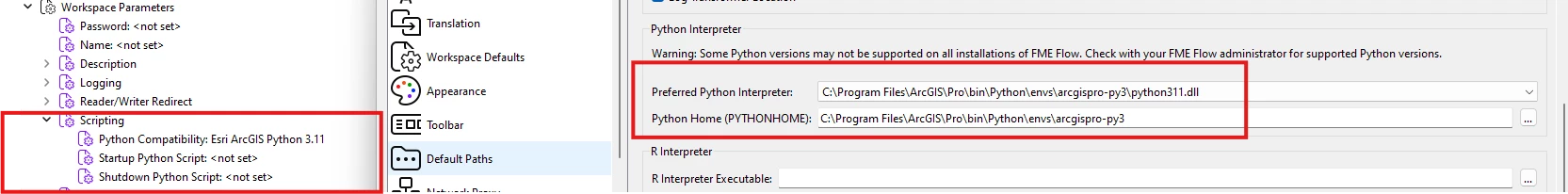

I have attached a screenshot of my current FME Options and Navigator settings for your reference. Could you please assist in identifying the cause of this issue and advise on how to resolve it?
Thank you for your support.
PS: Based on this article the Pro and FME compatibility should be fine
I have read this geodatabase before with older version of FME and it is a simple point data.
I’ve tried different version of Python Compatibility and got the same errors
Under Esri ArcGIS Compatibility I tested Auto and Esri AecGIS Pro and same errors happened

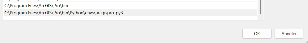

One possible approach to try, with no guarantee of success, is to add the following paths to the system environment variables (in the Path variable), then restart the machine and test again:
