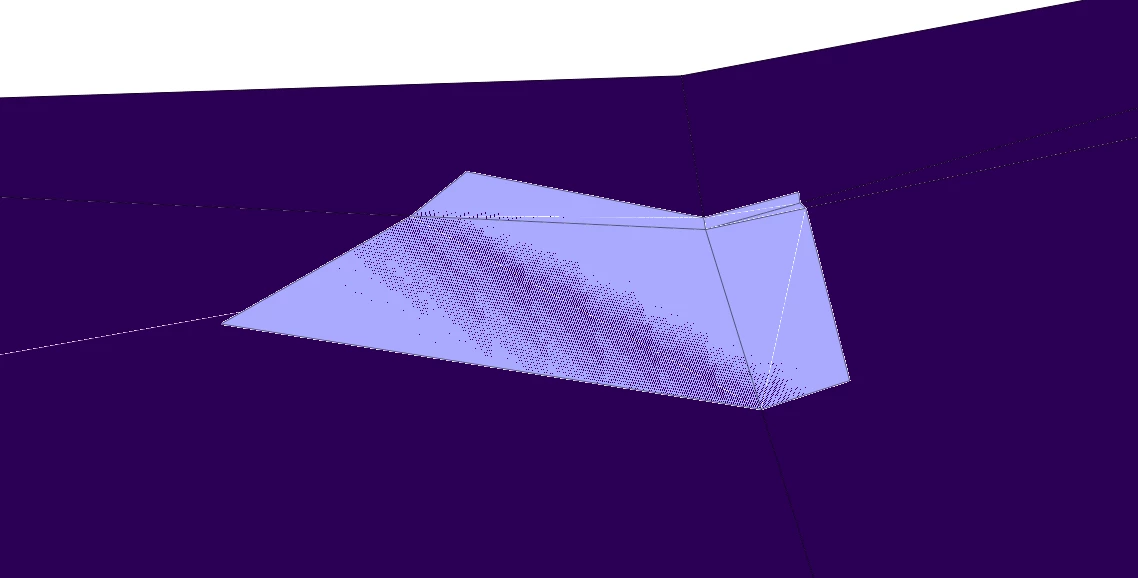

Here is a small sample.
If I use all 5 DGM triangles I get a Z-value from 53.135048715967386 and if I just use the triangle with the OID = 1067733 I get a value from 51.585430000182555 (the correct value).
My settings for the Draper are:
Surface Tolerance: 0.005
Preserve Deluanay by Adding Points
Breakline Tolerance: AUTO
Method: Model
Interpolation Method: Automatic
Replace Z

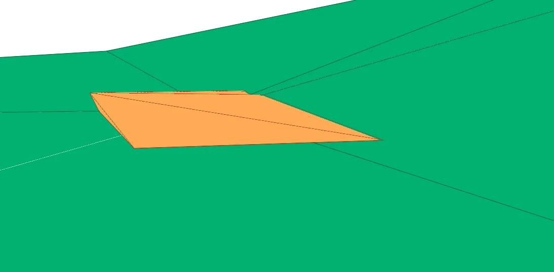

Would using a Clipper instead of the SurfaceDraper be an option for you?
Does look quite fitting for me.
My other idea was to use the clipped inside area as area in the SurfaceDraper, which does look better, but not perfect:
Though maybe it helps you.
Also I would recommend to use an AeraBuilder on your polygon as it is a MultiCurve - or is that intended?
